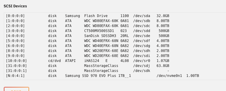

  1. Sure! Here they go. Not sure worth mentioning, but when I click on the Unmount button, it shows Unmounting but finally it seems to not succeed and shows again Unmount. Probably will appear on the diagnostics. Thanks again! talassa-diagnostics-20220529-2321.zip

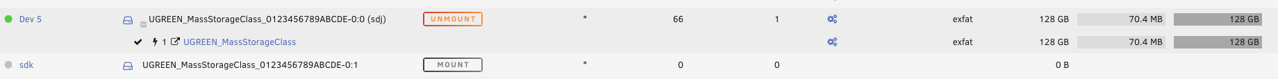

  2. Hi again, Just updated the plugin after some time being a bit disconnected, and quite pleased that this change solved my issue. https://forums.unraid.net/topic/92462-unassigned-devices-managing-disk-drives-and-remote-shares-outside-of-the-unraid-array/page/305/#comment-1121597 Now my SD card reader is properly showing the inserted cards after plugin moving away from the id serial short. Many thanks @dlandon !

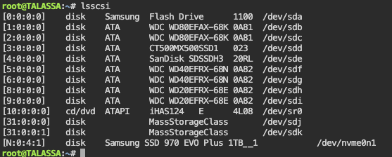

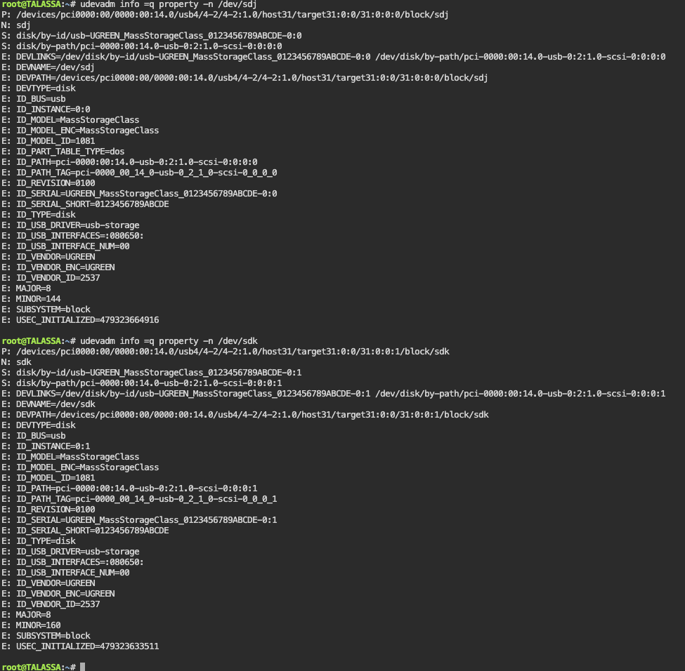

  3. Hi! Yes, lsscsi does show both j and k. See below: And also: Serial_short is the same while Serial not.

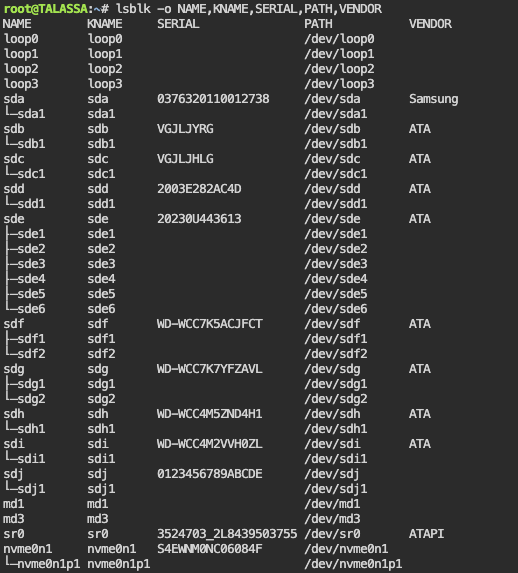

  4. Hi! Below the output of lsblk: Thanks a lot for the help!!

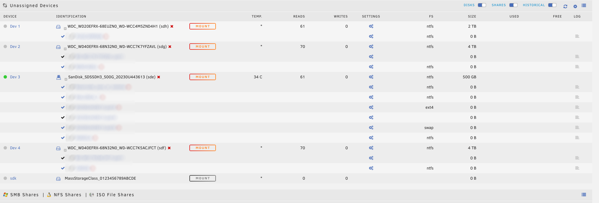

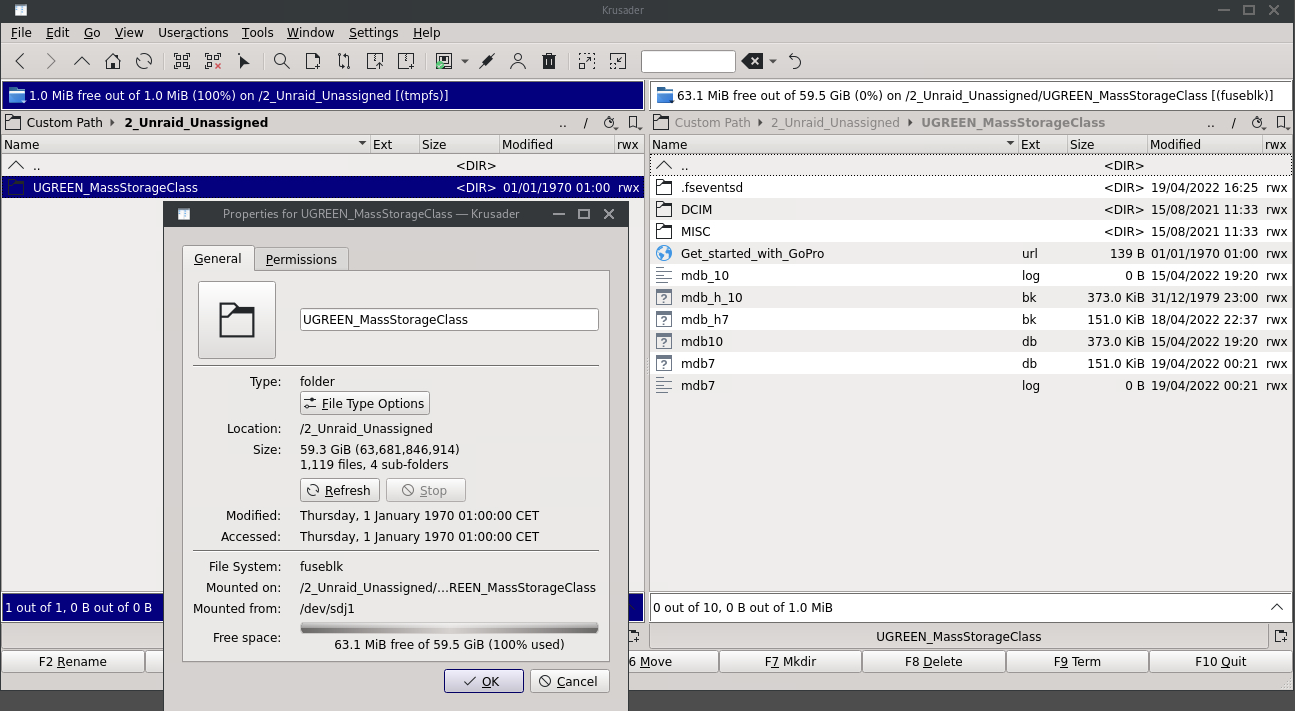

  5. What I am trying to do is empty the SD card, moving the data to the server all within the server. Not smb-sharing anything. With USB external hard drives, they show in the UD screen when plugged, so I click on mount, then I can start messing with files within the server. When done, unmount. Thanks a lot for the plug-in to do that! Expecting similar behavior, I do the same here: I insert the card in the USB reader, then plug the reader on the server. Just that. If any, the settings in the UD is auto-mounting. Not sure if that was the default value for that setting. When I plug the USB reader, and with all the microSD cards I tried (all used in gopros), I expect to see the exfat partition listed, so I can mount it, and then work with the files. However, UD screen only shows one partition with a greyed out mount button. System SCSI devices does show 2 partitions are seen by the OS, as per attached screenshot. UD does not show the partition which has the data in the drive, and which is shown in the syslog being properly mounted. On the other hand, the installed Krusader docker shows that partition, and I can deal with the files in there. Anyway, I will keep using Docker to copy the files, then unplug the drive without safely extracting it. Will use the laptop or the camera to format or remove files from the card, or whatever is needed. I thought this was something more evident that it seems to be. Thanks in any case!
  6. Hi again, Attached the diagnostics. Also added the screenshot. Thanks!! Edit: the device shown with the mount button greyed out is /dev/sdk. The whole SD card is one exfat partition -checked with gparted- so no idea where this sdk partition comes from. The partition where the data is stored, and which Docker is allowing to browse, is /dev/sdj. This one is not shown in the gui, as it can be seen in the screenshot. But Docker shows it, and I can pull the data from there. I did not manually mount anything. talassa-diagnostics-20220502-0122.zip
  7. Hi all! Just a doubt: I have to be missing something pretty obvious, but cannot figure it out. Really new Unraid user here. Unraid OS Plus 6.9.1 Unassigned Devices, version 2022.04.20. UD is set to auto mount. Unassigned Devices Plus, version 2021.12.12 I am trying to mount/unmount an exfat formatted micro SD card used in a GoPro, the same way I do with other drives. In main tab, the sd card is shown, MassStorageClass_0123456789ABCDE, but with the Mount button greyed out. Thus, not able to explore it there. However, Krusader docker is able to browse it. Although I can successfully access the content, I am wondering if I am doing something wrong because of that disabled Mount button. Also, when I have all the content in the server, not sure how to safely unmount/remove the card... As a result, always reading the drive instead of moving. I am using a USB card reader for this: [8086:8c31] 00:14.0 USB controller: Intel Corporation 8 Series/C220 Series Chipset Family USB xHCI (rev 05) Bus 003 Device 001: ID 1d6b:0002 Linux Foundation 2.0 root hub Bus 003 Device 003: ID 090c:1000 Silicon Motion, Inc. - Taiwan (formerly Feiya Technology Corp.) Flash Drive Bus 003 Device 004: ID 0463:ffff MGE UPS Systems UPS Bus 004 Device 001: ID 1d6b:0003 Linux Foundation 3.0 root hub Bus 004 Device 002: ID 2357:0601 TP-LINK USB 10/100/1000 LAN Bus 004 Device 003: ID 2537:1081 UGREEN USB3.0 Card Reader That group is not passed through. After enabling the UD logging: (....) unassigned.devices: Adding partition 'sdj1'... unassigned.devices: Successfully mounted 'sdj1' on '/mnt/disks/UGREEN_MassStorageClass'. unassigned.devices: Adding SMB share 'UGREEN_MassStorageClass'. unassigned.devices: Mount drive command: /sbin/mount -t 'exfat' -o rw,noatime,nodiratime,nodev,nosuid,umask=000 '/dev/sdj1' '/mnt/disks/UGREEN_MassStorageClass' mount.exfat: bad centiseconds count 254 unassigned.devices: Successfully mounted 'sdj1' on '/mnt/disks/UGREEN_MassStorageClass'. unassigned.devices: Adding SMB share 'UGREEN_MassStorageClass'. unassigned.devices: Udev: Update udev info for /dev/disk/by-id/usb-UGREEN_MassStorageClass_0123456789ABCDE-0:0-part1. unassigned.devices: Mount: Received a udev 'add partition'. unassigned.devices: Processing Hotplug event... Please, any idea of how to properly manage this sd card? What I am doing wrong? Many thanks in advance!
