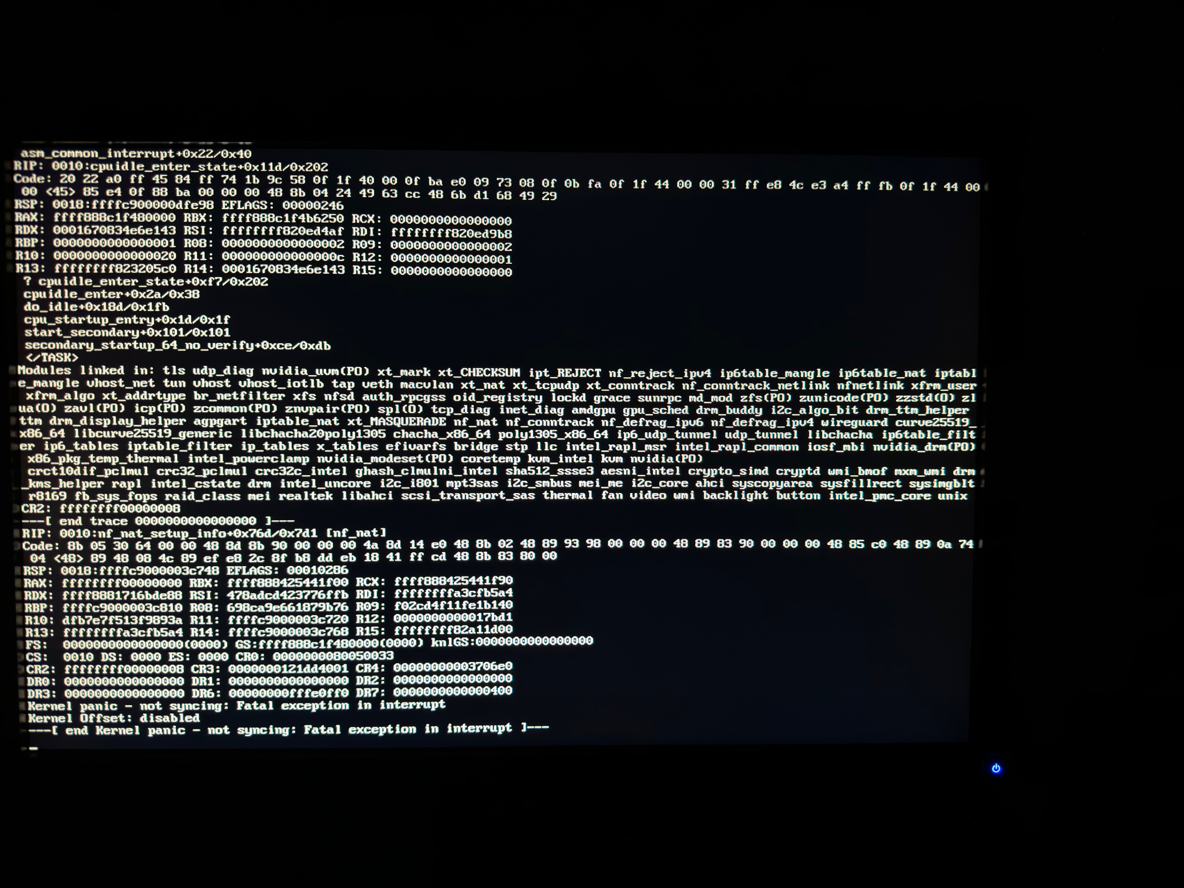

  1. Good morning Jorge, my system crashed yet again, and this time I have the syslog server attached! It seems like it must have crashed on June 13th just past midnight. I don't really understand what the error messages are displaying though. Please let me know if you have any questions. Also, probably unnecessary but I've run memtest to ensure there are no problems with RAM. I didn't see any errors from the memtest run. syslog-192.168.1.150.log

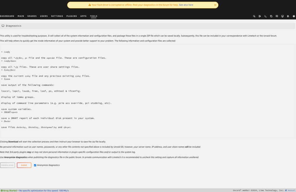

  3. Yes that is correct. The diags are after rebooting and when UNRAID was no longer showing the error. I was unable to obtain any diagnostics when the flashdrive error was present. The second image that you see, where it states "File not found." was the only information I was getting while trying to navigate the GUI.

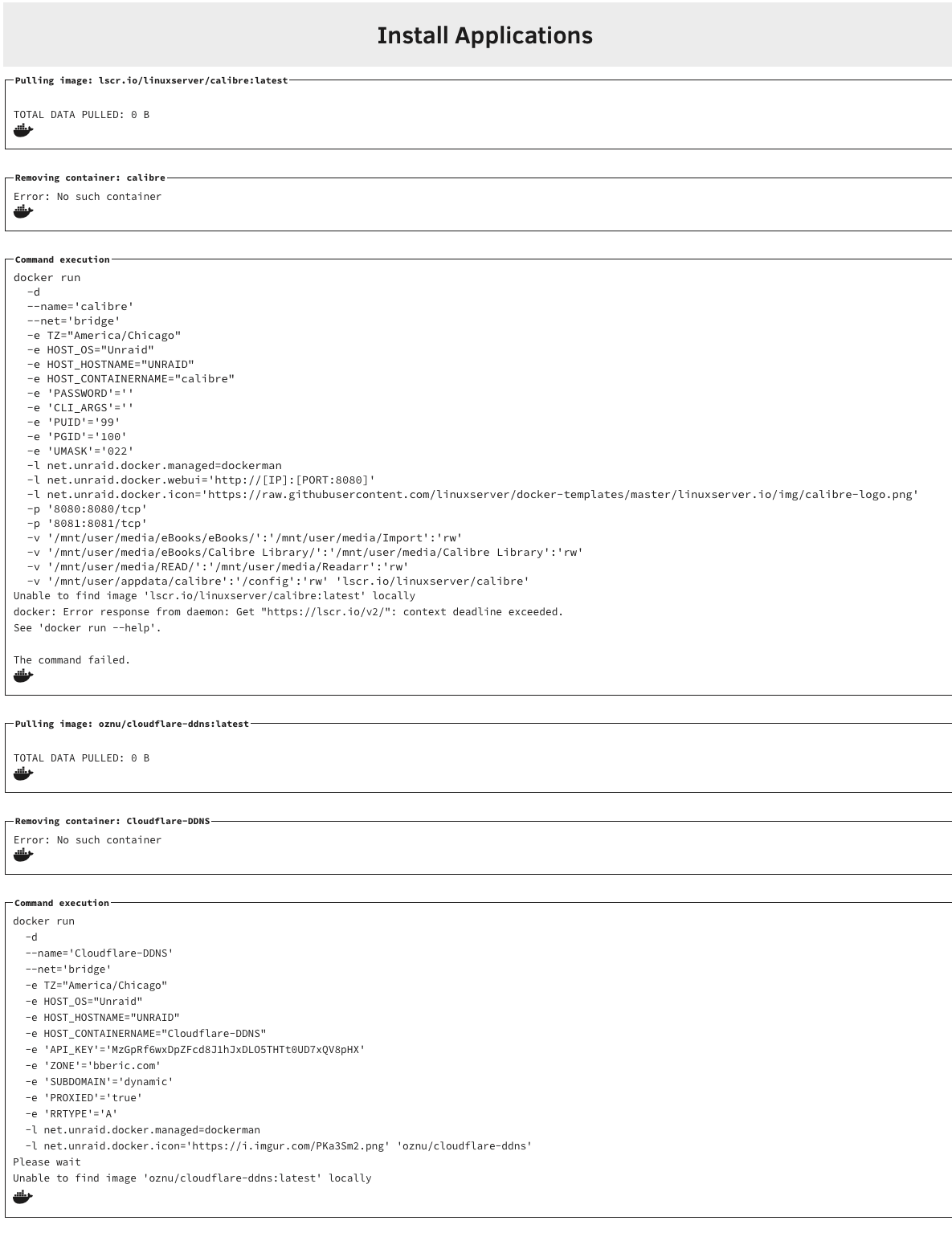

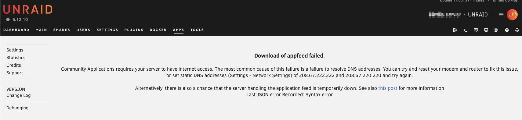

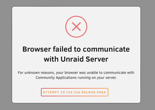

  7. Wow, thanks Jorge. I've tried a new flash drive with a fresh install and it didn't work either, so I found a spare network card to see if the mobo ethernet port was bad. Indeed it was the problem. Interesting that I can still connect to the server GUI but it has issues with accessing the WAN... anyway, thanks!

  9. Good afternoon! I've recently migrated to new server hardware for my unraid server and have been having a lot of issues. I went from an old Intel Xeon processor set up to a newer AMD Ryzen 5 setup from 2020. I didn't change anything else other than the processor and motherboard. I am having problems with community applications plug in not communicating with the proper channels to allow for download of docker containers accessing docker containers remotely. (for example, I tried accessing Krusader, but I cannot connect to it) Also, whenever I change network settings, it takes unraid GUI an unbelievably long time to be able to access from my laptop. This was never an issue before. What I have tried to fix the issues: For community applications not being able to connect to its resources: I've tried changing unRAID DNS to the OpenDNS server lists as suggested in one of the pinned posts. I've also tried cloudflare DNS to no success. I've also restinalled the plug in, but that didn't change anything. For the docker container GUI being inaccessible, I've tried to reboot my router and modem, but that didn't do anything either. IT seems like this networking-ish issue is limited to the unraid server. I am able to access the internet on my other devices such as my phone and laptop. I've never had any issues and had a great time using unraid up until this point. These issues are all completely new to me. I've attached the logs you may want to see to this post. You'll see two, because the earlier one is from version 6.12.8, and the newer one is from 6.12.10. I updated the version in case it may solve the problem. Unfortunately it didnt.... Thanks in advance for your help. unraid-diagnostics-20240406-0254.zip unraid-diagnostics-20240406-1835.zip

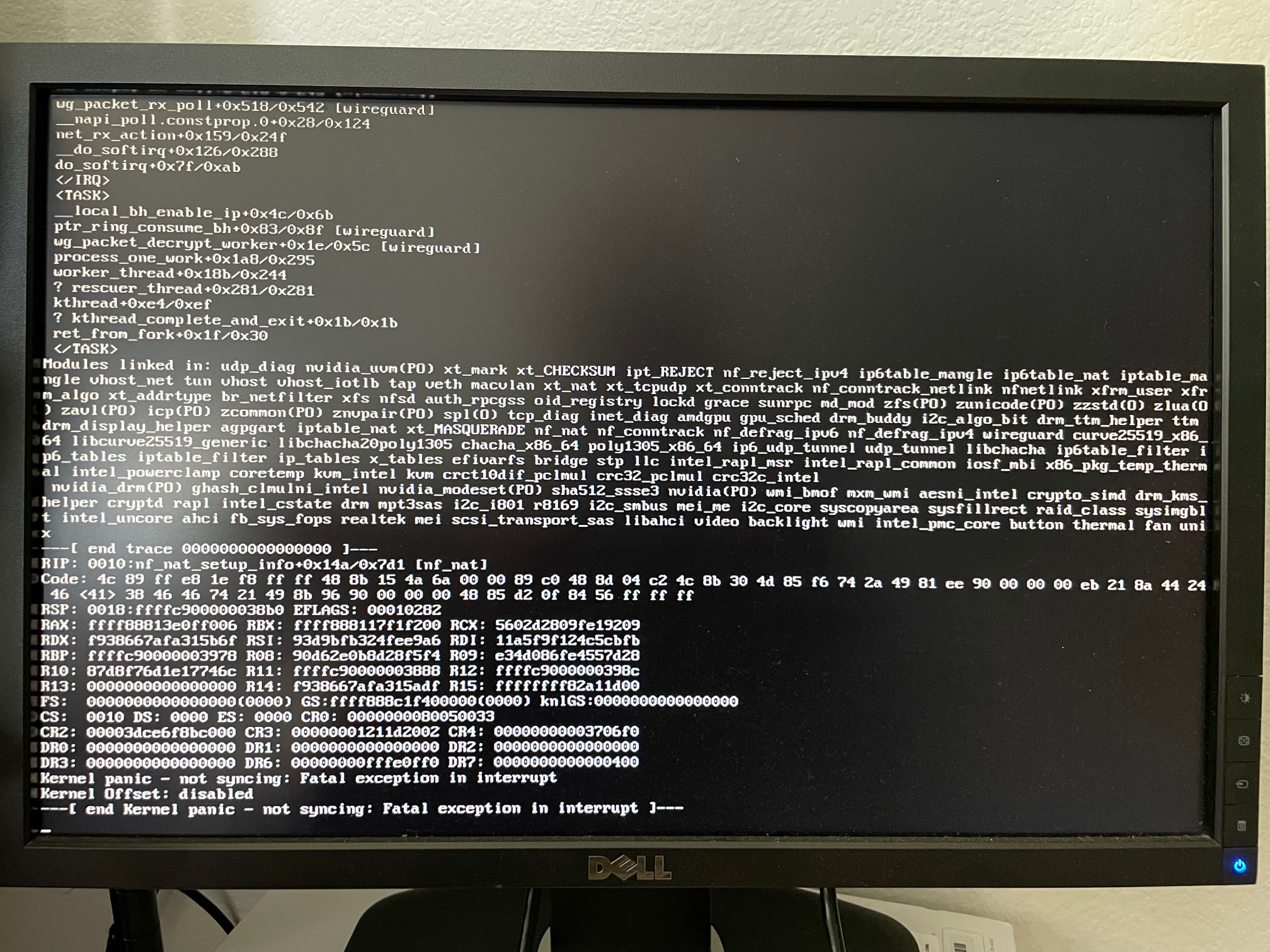

  11. Good afternoon everybody, I have an Unraid server that keeps on crashing and I don't know what's going on with it... As you can see in the images below, it shows a bunch of things, but I unfortunately don't know how to interpret this. I've also included the diagnostics ZIP to assist with questions you may have. this started recently, within the last two weeks. My server crashed like this roughly 3 times within that time period. I installed a graphics cards back in June, but I don't think that hardware is the issue. If it's related to that, I figured I would have had some problems since the installation of the graphics card. I also checked the graphics driver just in case, and the driver hasn't updated for more than two weeks, so I don't think it's a new driver that's causing issues either. I currently have a nVidia 2060 for transcoding in Plex/Jellyfin Please help me solve this issue... If this keeps on happening, I'm afraid I'll lose my data... Thank you in advance! unraid-diagnostics-20231012-1631.zip

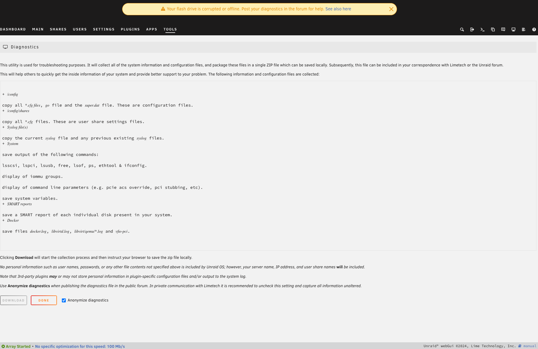

  14. Hello folks, I logged into my server today to find the following error message: " Your flash drive is corrupted or offline. Post your diagnostics in the forum for help" I've downloaded the diagnostics text files. There are a lot of them and I don't know which one to upload that would be relevant. Could you all please help? Thank you!
