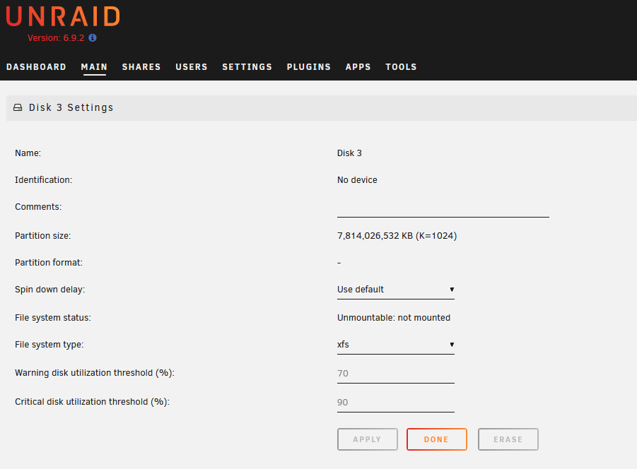

Here is the output from the command line xfs_repair: xfs_repair_output_disk_3.txt Do I still need to stop the array and change the file system on that disk 3? -

1) Going to switch to maintenance mode -- 'apply changes' was not available as an option after I switched from 'auto' to 'xsf' -- UPDATE: still leaving apply changes greyed out weven in maintenance mode - attempting command line now. 2) Oh - absolutely not going to act on any assumptions --- you've devoted way too much time to helping me for me to hose things up by just acting about something I'm not 100% certain on at this point. 🙂 -

MooTheKow replied to MooTheKow's topic in General Support
This is what I see on disk 3 settings. I can change it to 'XSF' and click 'Done' - but then it just reverts back to auto.
