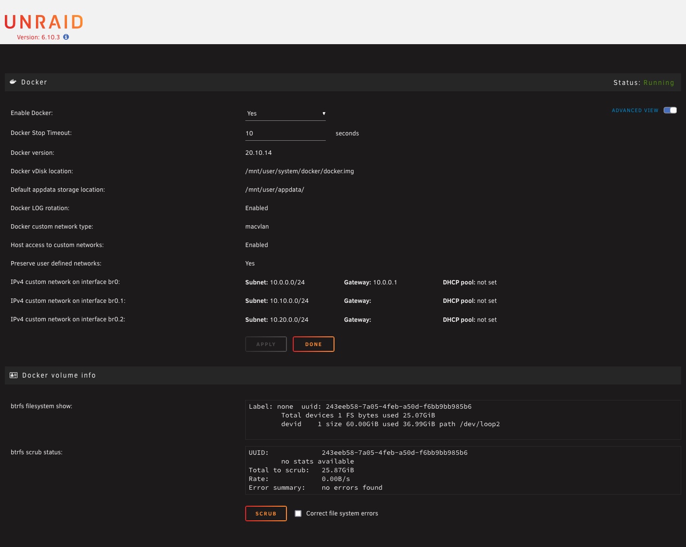

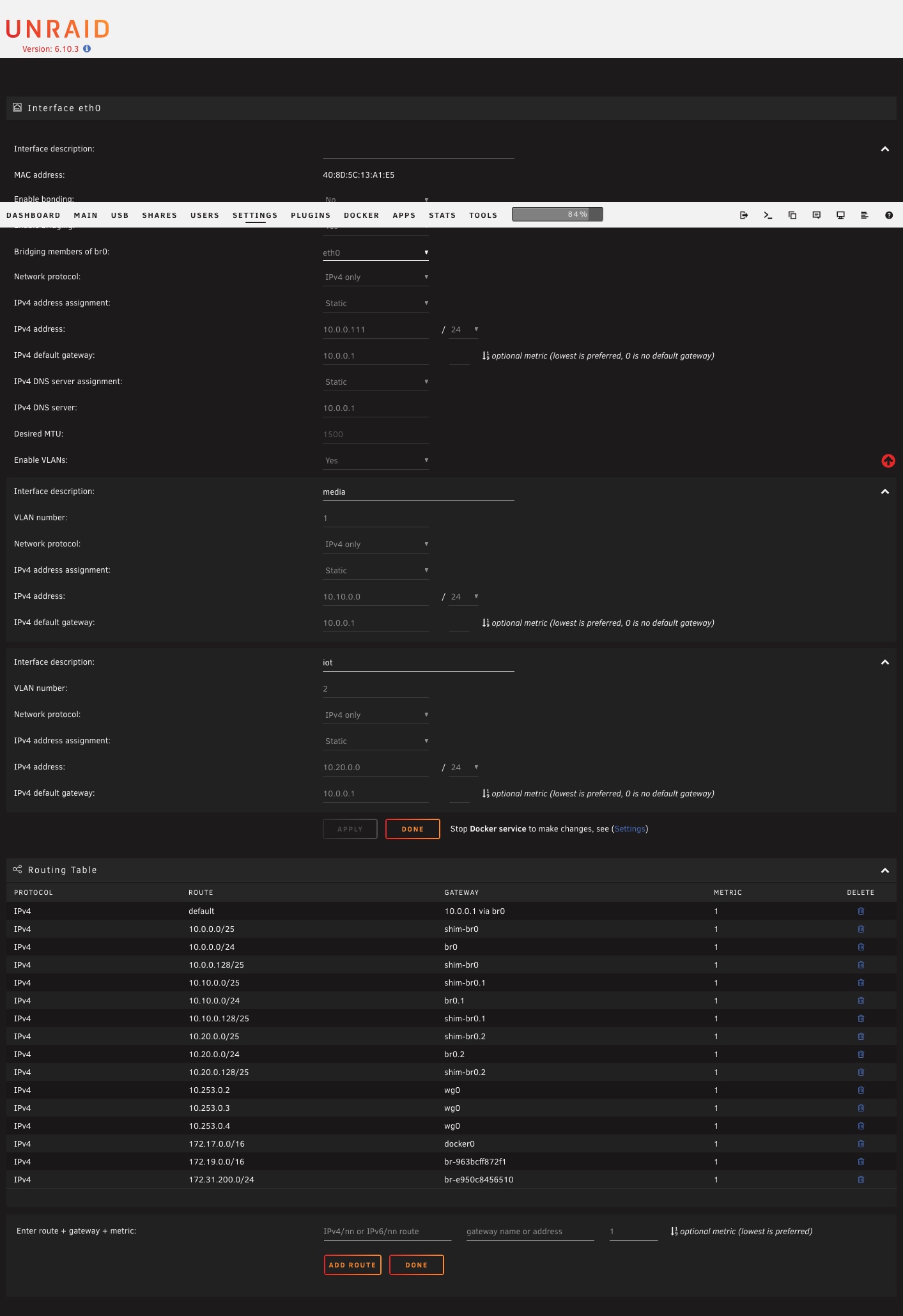

  7. Hello. I have a few dockers with static IPs set via br0 They work great for unspecified amount of time, 10 until the last occurence, then become unreachable. my setup 192.168.0.1 - gateway 192.168.0.2 - server 192.168.0.10 - dock1 192.168.0.11 - dock2 i have console access to dock1 from unraid web interface i CAN NOT ping dock1 from server . dest host unreachable i CAN NOT ping server from dock1. dest host unreachable i CAN ping gateway or dock2 from dock1 looks like by bridge gets broken but i can not find a way to prevent it or restore without reboot. Any advice appreciated. How to catch a bug? What log can contain useful data? How to repair bridge wo reboot?

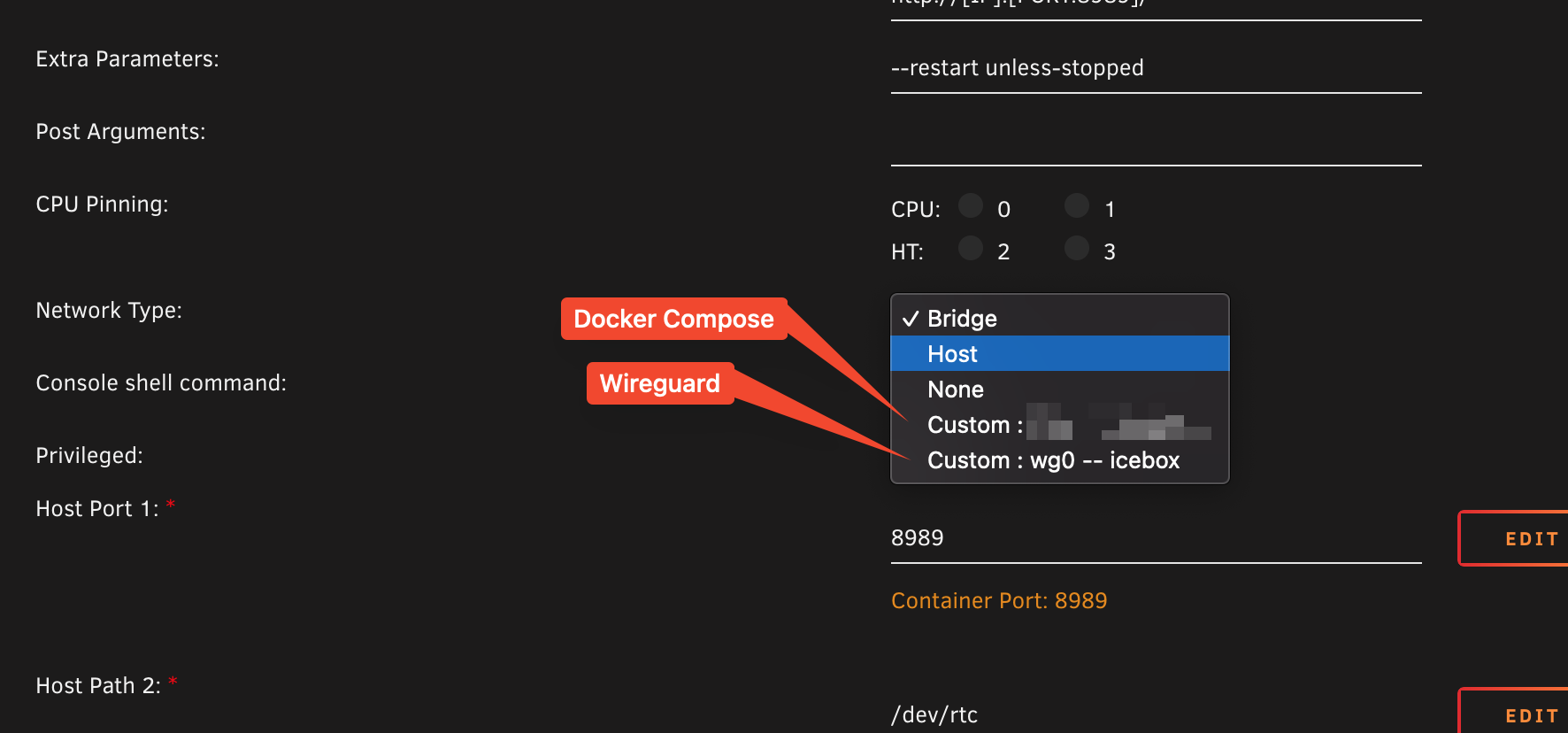

  8. 6.10.3 Yesterday I configured few dockers to use fixed IPs via custom network br0. Next day br0 was gone and I had to disable\enable bridging to restore it. However custom networks created in "Network settings" do not appear in docker template options anymore. I can see custom networks for wireguard and docker compose but no br0 or vlans that i created in attempt to fix it. Partly solved Looks like it failed to create 'br0' under Docker. A quick workaround is: rm /var/lib/docker/network/files/local-kv.db /etc/rc.d/rc.docker restart br0 is back What went wrong and how can I fix it? Network settings Docker settings Container settings Also docker.cfg has a weird string DOCKER_CUSTOM_NETWORKS= " "
