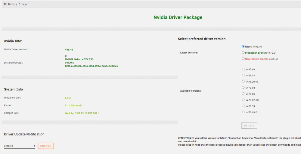

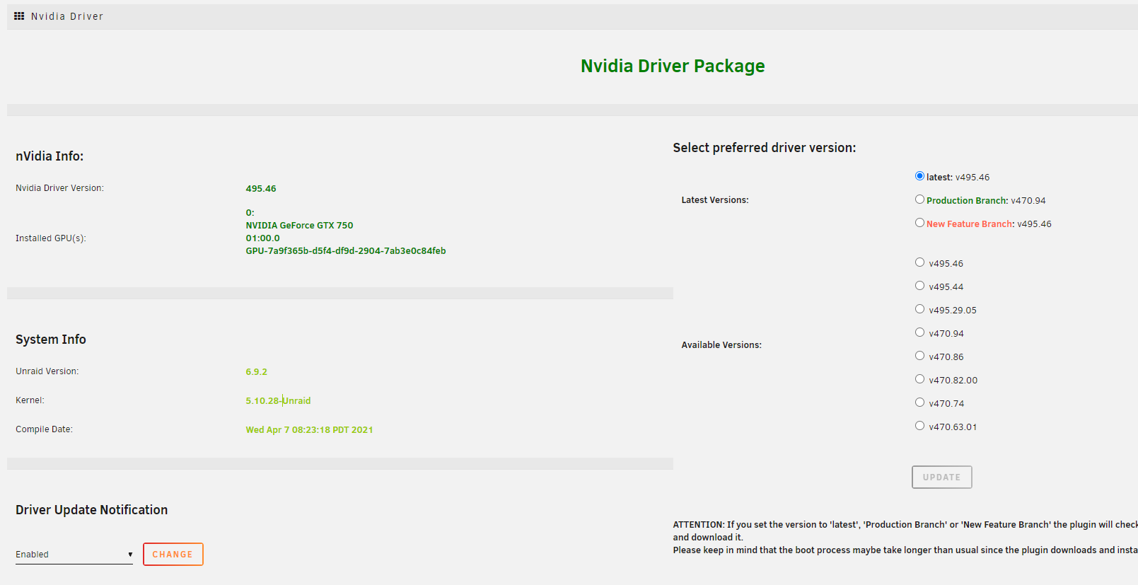

  8. Now I see. Thanks for help. So the correct startup process like these? 1. Unraid Server bootup 2. plugin installed and extract daemon.json into /etc/docker/daemon.json 3. go file loaded, extra mirror line injected into daemon.json and emhttp called 4. Docker service start with json configuration 5. containers startup in order 6. related container run up with runtimes
  9. Does the driver package append the runtime command into /etc/docker/daemon.json or replace it automatically after downloading completely? mkdir -p /etc/docker tee /etc/docker/daemon.json <<-'EOF' { "registry-mirrors": ["https://docker.mirrors.ustc.edu.cn"] } EOF I think it's my personal issue that I have edited /boot/config/go to create /etc/docker/daemon.json and change docker image registry mirror to mainland local server before I installed Nvidia Driver plugin. Is the plugin priority lower than system boot, so the daemon.json being overwritten by "go" file, not by plugin?
  10. Probably just network issue. My unraid server usually failed to download plugins and it makes them running with something missed. I've done all steps in normal way including disable docker service and enable it via WebUI. Also trying reboot Unraid Server serveral times and not helping. Downloading files from foreign websites is always painful and fails easily on my country mainland . Maybe the runtime parameter didn't take effect while failing to install Nvidia Driver plugin. (even the webUI displays "install sucessfully") So I just place it manually into the daemon.json file and the Emby container runs correctly with GTX750 hardware transcoding. BTW, I appoint http_proxy in the /boot/config/go and the whole system network access (to CA or others) seems fine.
  11. Alright, I think I figured it out by myself. I just add runtimes in /etc/docker/daemon.json and restart docker function once. Then the Emby container could use the nvidia runtime by adding extra parameters now. It‘s troublesome that I can't access domain or website related to Unraid and the plugin cannot be installed normally because I'm living in China. I'm expecting editing http proxy via webUI in future version.
  12. I have installed all things I can and the Nvidia Driver seems works fine. But it's werid that I can't startup the Emby Container with "--runtime=nvidia".
