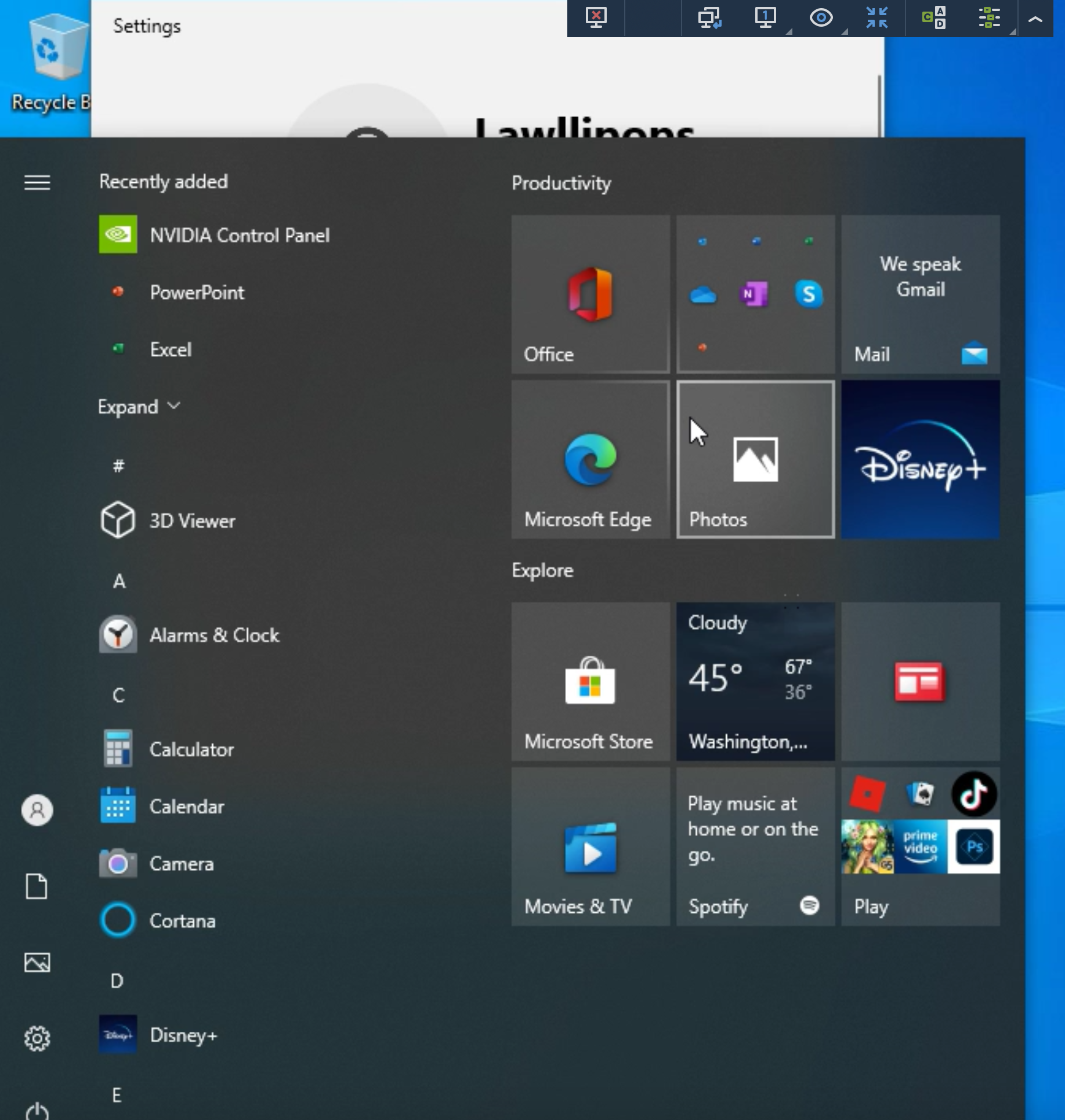

Hey, I was able to get my GTX 1650 OC passthrough to my windows 10 VM, and I was using splashtop to connect to my VM, but when I connect the background looks blank, but I am able to still sign up to my windows machine. When i login to screen is again blank, but if I click on the windows Key i am able to bring up the start menu, and the background flashes on, but when I try to do anything everything runs really slowly. When I had everything setup on VNC everything worked fine, but not sure why its getting some blank screens and why everything is so laggy. Anyone got any advice?
