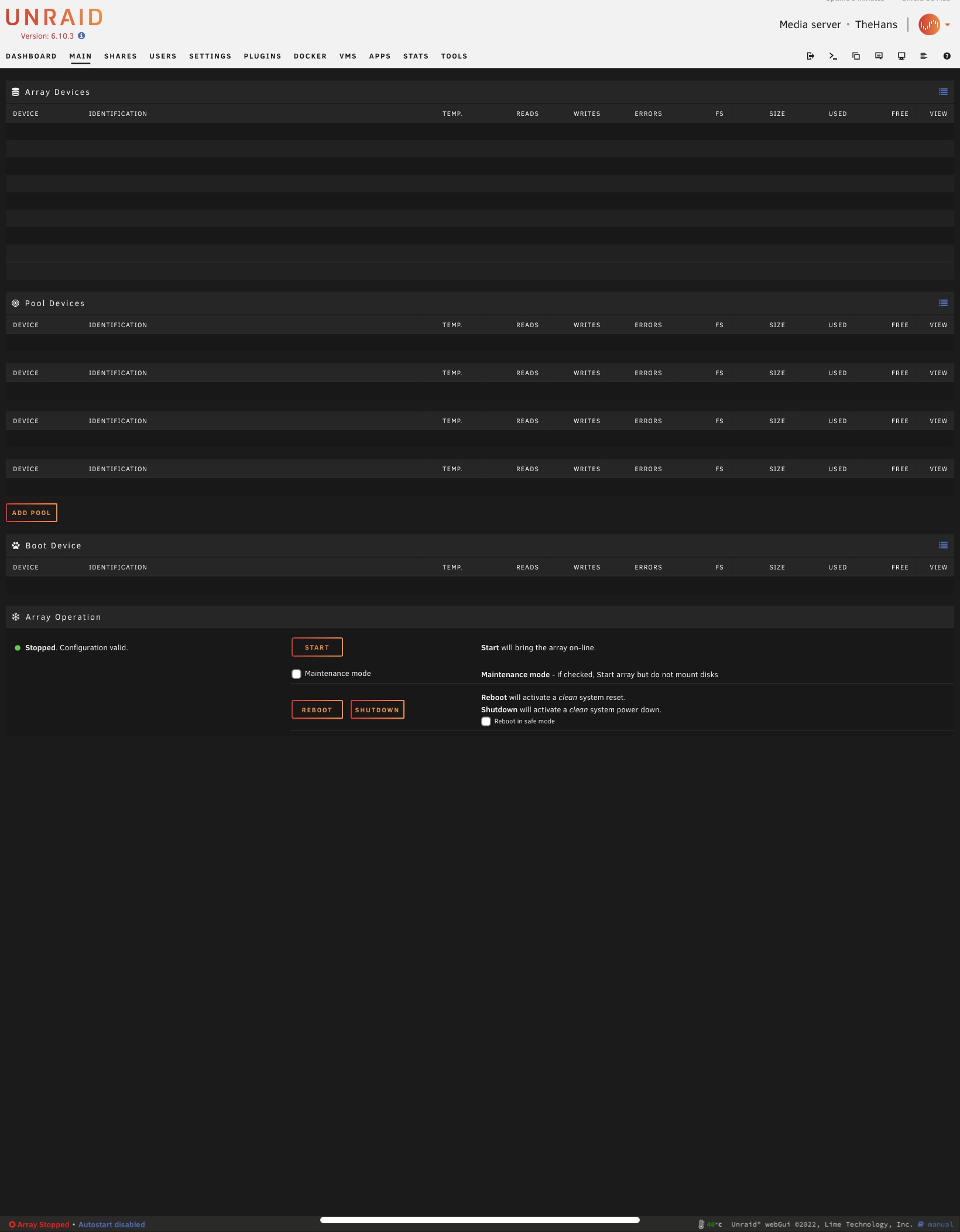

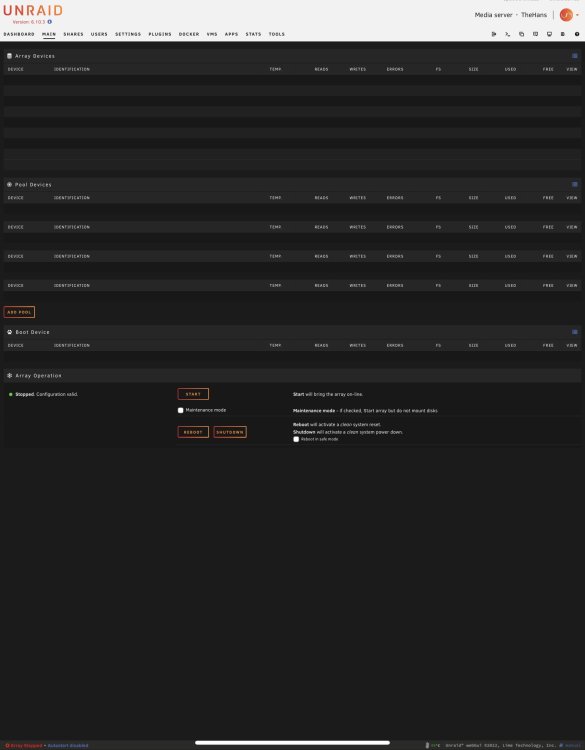

I was recently having troubles with my unraid server, and found that I had bad ram.
I was able to replace it today and installed it, but when I go to boot unraid there are no disks for the array parity or cache.
(See image)
I also added my logs.
Not quite sure what else to do

All devices are being detected, looks like a GUI problem, try rebooting in safe mode and/or use a different browser (after rebooting also).
I’ve tried safe mode but no luck. I am planning on replacing my flash drive as well so I guess we can see how that goes
Do you have a current flash backup?
Unfortunately no. But I read that I can copy my confit folder over and then when I boot up I will have to click on get registration key.
good news is I booted up and all my drives appear. I have not started the process on the registration key yet.
I wonder if one of the files in my flash drive got corrupt.
I ran the chkdsk on my flash drive and no errors appeared.
I created a new flash drive and everything works. I think a file on my flash drive got corrupt or something but everything seems to be working fine now
