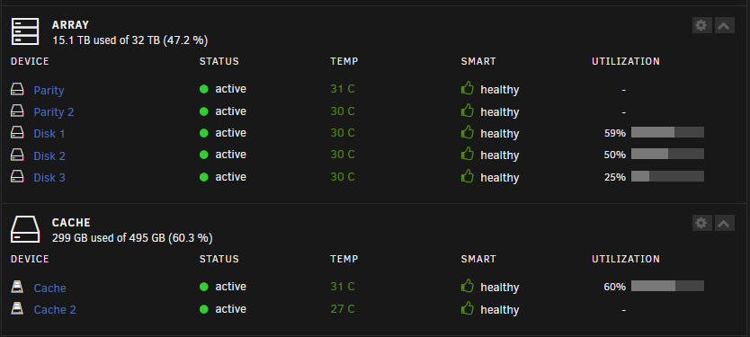

  9. That was my thought. And you're right about other issues too. This morning the cache pool had returned to normal, but I couldn't get the docker service to start without initiating a full restart. Maybe I could have if I knew hot to do it from the command line. But back when this was a little more regular, the GUI would crash as well. The only thing that I can think that would do that much writing to the cache would be something like SABnzbd. But that hadn't had any activity since 11 last night. Could it be running a backup of my HomeAssistant VM? Those backups are only ~400MB though. No. They don't start running until 2:00am. I'm stumped for now. Is there a way to log the disk utilization by service?
  10. That's what I see for disk utilization normally. But overnight I'll get notifications that read: Unraid Cache disk disk utilization Alert [GEMINI] - Cache disk is low on space (100%) Description PCIe_SSD_21010751200007 (nvme1n1) Priority alert. I got that at 1:11am. That was the last one I got. The first one started at 12:41am at 71% and went up from there. I will attempt to restore the sanoid.conf file and run a memtest to be sure. I'm trying to research what a sharecachefloor means, but not getting far.
