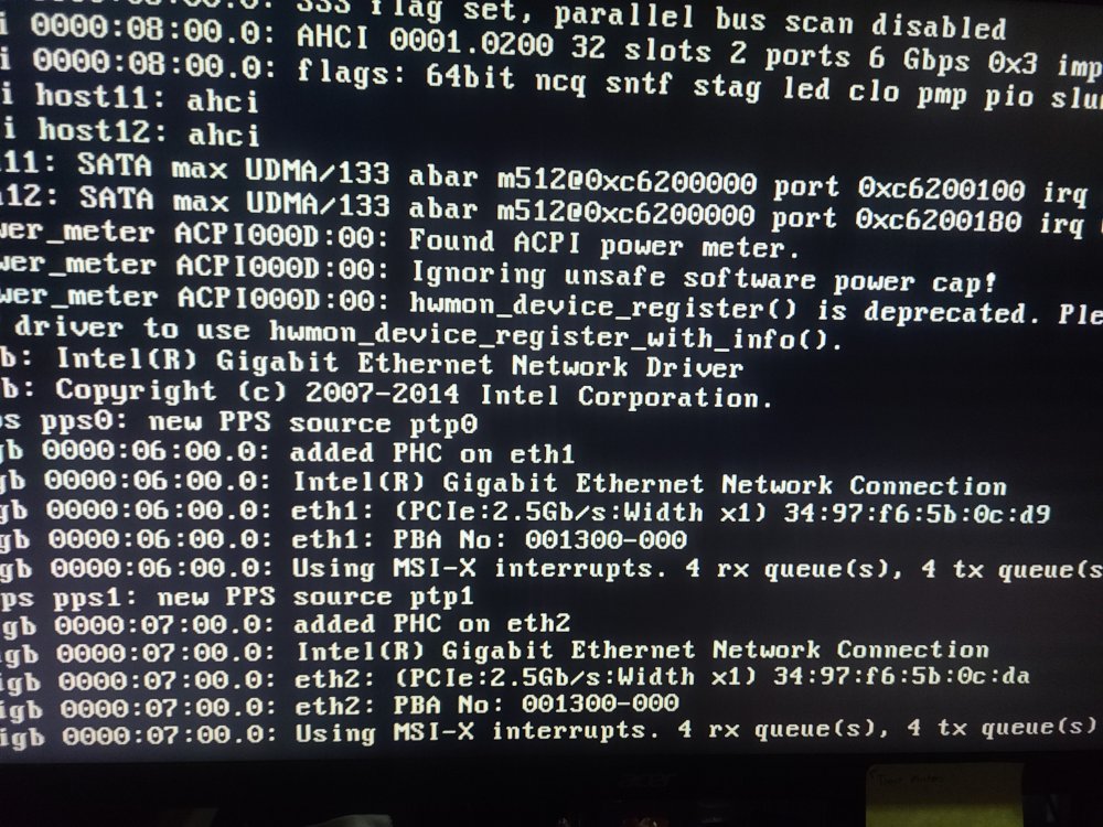

  3. Got some time to work on this again today. I tried updating from 6.9.3 to 6.11.1 and loading into all of the options: GUI, No GUI, Safemode, and GUI with no plugins. All of the options fail to load in the same location. I am uploading the log from the no GUI attempt. Seems to look similar to the previous attempts. Times of the attempt: 10-22 @ 10:17 Update to 6.11.1 10-22 @ 10:20 reboot the server 10-22 @ 10:23 boot freezes. Again, everything seems to load but just stops. syslog -10-22
  4. Nope, it completely freezes. No cursor or ability to access it. I have let it sit that way overnight thinking maybe it was processing something and it doesn't change. Just sits in the say location on the loading screen.
  5. I am able to see the first gui that asks if I want to boot to command line or GUI, but it never loads enough for me to actually see the GUI screen. It locks up before the second GUI loads.

  12. Apologies, they should be attached now.
