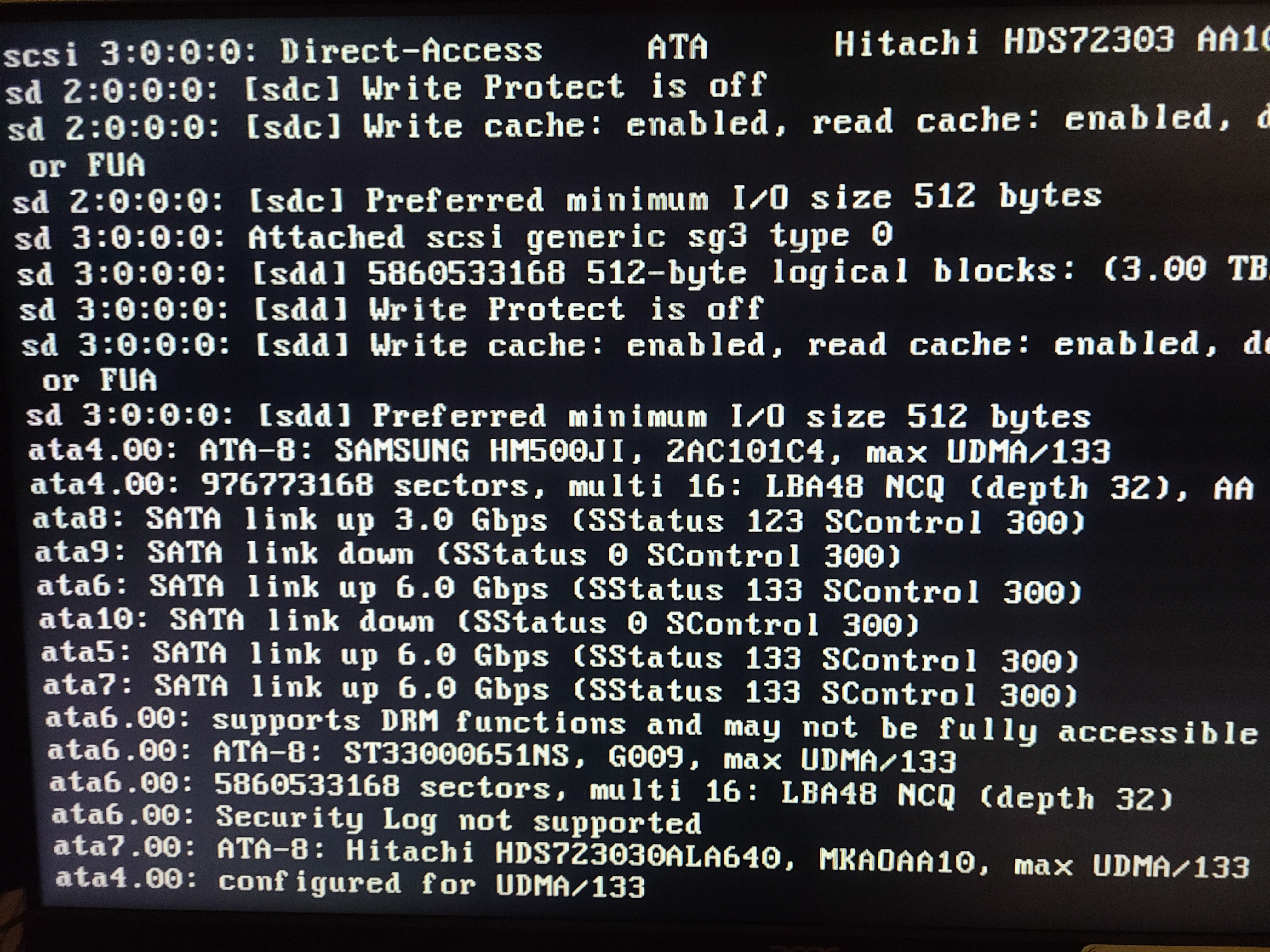

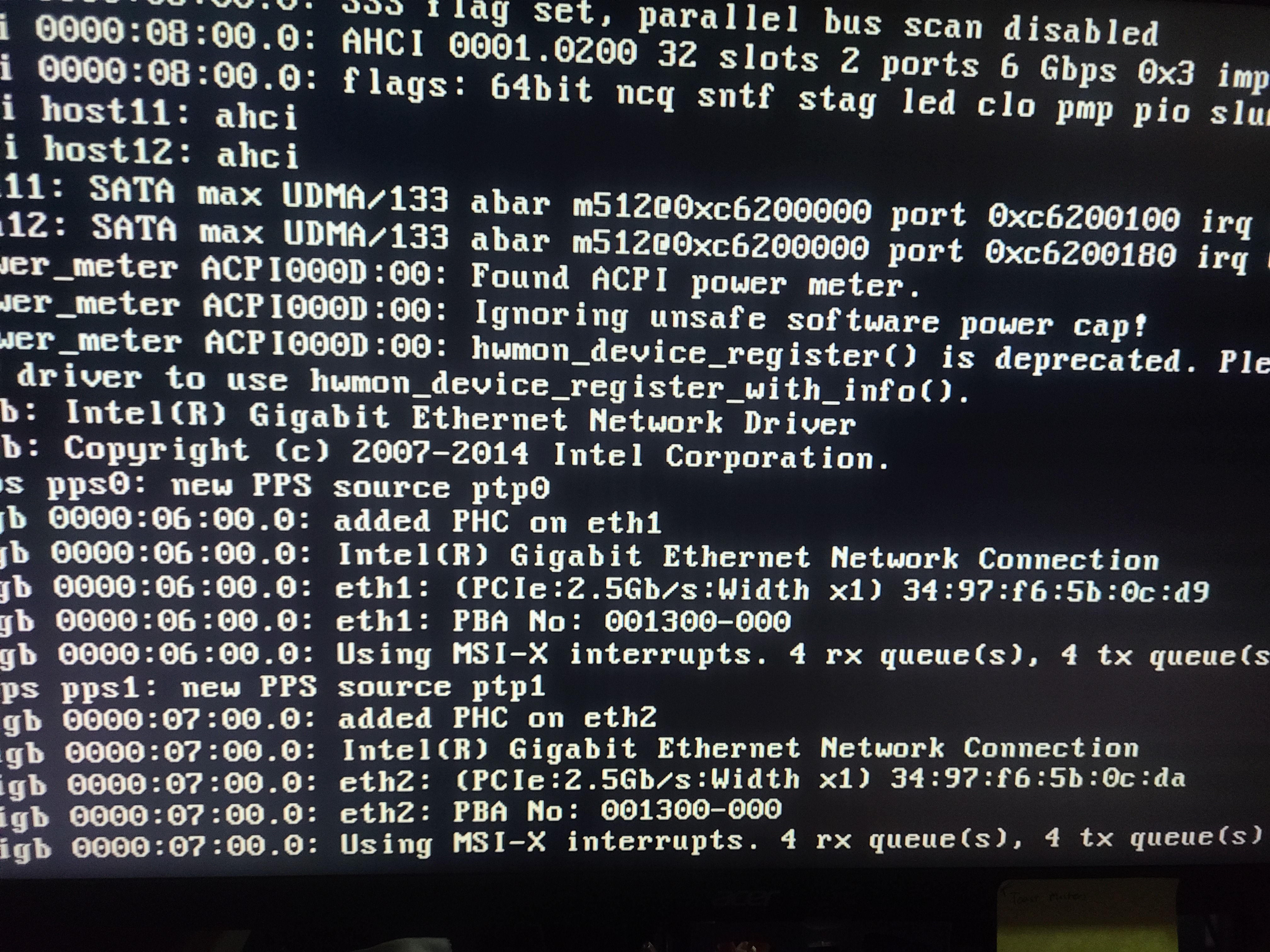

Rebuild my flash drive from my backup, made sure it loaded and all my VMs were functioning, then manually updated the USB stick and copied the config files over. Didn't work... decided to capture an image of where it stopped: Image1

Thought the issue might be the config, so I loaded 6.10.3 from scratch on a new USB drive and tried to load that(I knew it went error out from registration, but was hoping it would atleast load). Here is where it stopped during the loading process: Image2.
Since the OS will not load, I have no way to pull logs to upload, just capturing the images of where it stops.

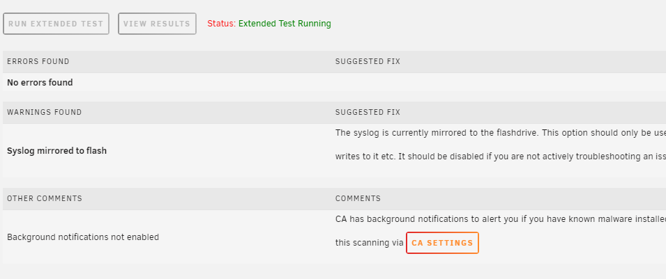

I did see that there was a new version of fix common problems. Updated it to that version:
Again, no issues here.

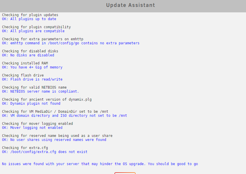

Reran the update assistant and still no issues:
