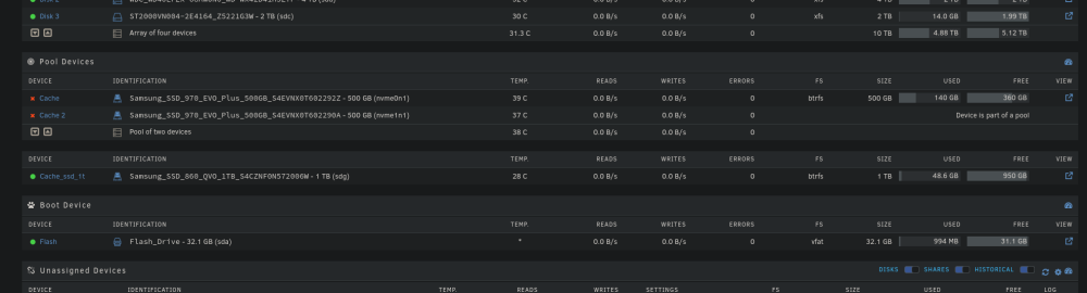

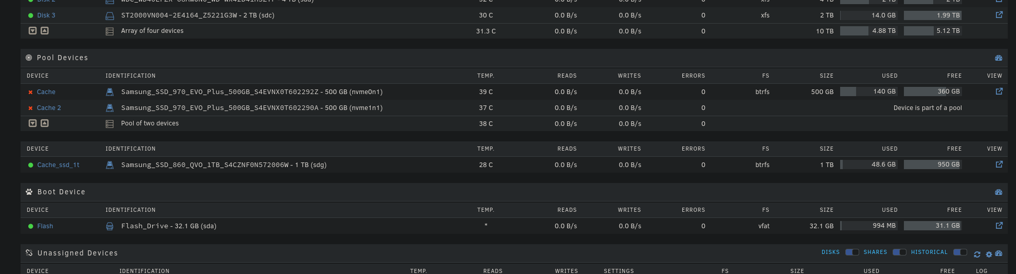

  2. when i ticked the box that said remove the missing devices and start the array all was good stoped the array again and re-assigned the correct drives and restarted the array all fixed thanks a lot

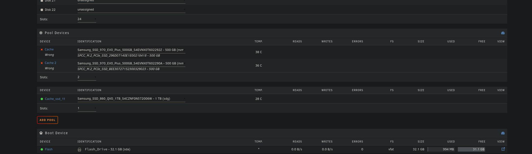

  3. array wont start with none selected in both slots can i do any harm by removing the phantom devices form the config file ? I should add that i had replaced both of these ssd a week ago but have not had any problems until today. Is it safe to asume that the phantom drives that the system is looking for where the old ones i took out ? and that is why i have two lots of entrys in the config file?
  4. So this is the contents of confg > pools > cache.cfg should edit this file and remove the lines ? diskId="SPCC_M.2_PCIe_SSD_296D07140E1E00218418" diskId.1="SPCC_M.2_PCIe_SSD_BEE30727152300329023" or am i on the wrong track ? ========================================= diskFsType="btrfs" diskComment="" diskWarning="" diskCritical="" diskUUID="1d576a90-08fc-4b93-851e-0f7c1134e608" diskShareEnabled="yes" diskShareFloor="0" diskExport="-" diskFruit="no" diskSecurity="public" diskReadList="" diskWriteList="" diskVolsizelimit="" diskCaseSensitive="auto" diskExportNFS="-" diskExportNFSFsid="0" diskSecurityNFS="public" diskHostListNFS="" diskId="SPCC_M.2_PCIe_SSD_296D07140E1E00218418" diskId.1="SPCC_M.2_PCIe_SSD_BEE30727152300329023" diskIdSlot="Samsung_SSD_970_EVO_Plus_500GB_S4EVNX0T602292Z" diskIdSlot.1="Samsung_SSD_970_EVO_Plus_500GB_S4EVNX0T602290A" diskType="Cache" diskType.1="Cache" diskSpindownDelay="0" diskSpindownDelay.1="0" diskSpinupGroup="" diskSpinupGroup.1="" ===============================================
  5. Hi guys I have a problem, after I updated my motherboard Bios both of my SSDs in my cache pool are marked as wrong. When i log in the array is stopped after reboot. They both seem to have the same names that they had when installed but unraid is expecting different drives. when i start the array the pool looks to be working, I can browse the files and start and run docker containers that live on the cache. I have tried using the new config tool preserving array allocations only to no avail. any help would be appreciated laurelin-diagnostics-20220910-1605.zip
