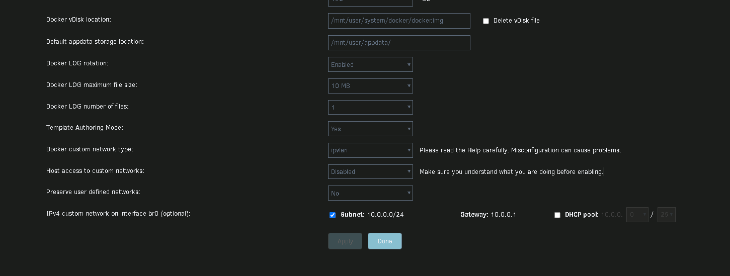

No it has been off for months. Could it be using it even though I turned it off? I promise you I turned that thing off more than a few months ago and when I checked it was off still. See screenshot. I just turned on the logs you mentioned it is resetting more often. I'll get you those diagnostics next. If the macvlan thing is an issue would it be best to make a new flash drive and just redo my containers inside the docker? I have no VMs or anything else and I've done it before as it kind of 'cleaned' out my Unraid. Not sure if that is a viable solution, but I did so many bad things while learning.
