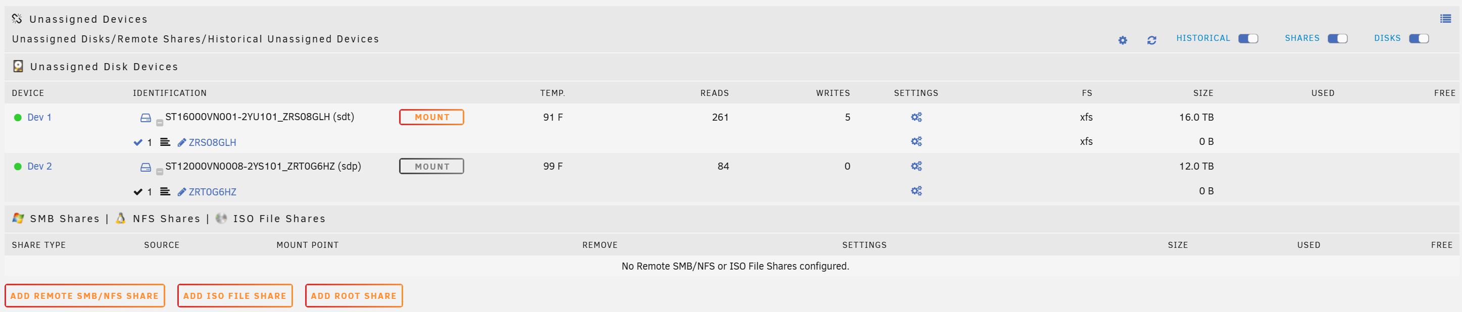

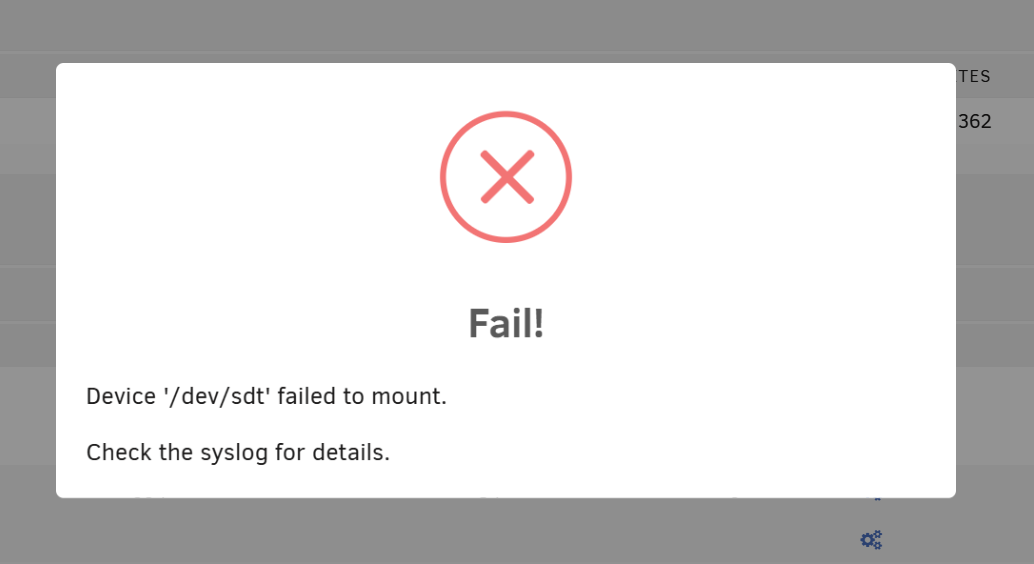

  8. I have two disks that I can't get mounted. I don't recall these two disks being unmounted in the past. I just happened to look in the Main tab in Unraid today and noticed both of these weren't mounted. The log tells me that I should run xfs repair on the disk. That doesn't appear to help anyone from what I've been able to read in the comments. The Mount button is greyed out on the other disk ("Dev 2") so I don't know how I can even attempt to mount it. Any idea how I can get these two drives mounted? Also, did I lose any data or was all of the data recovered using my other drives? Below are screenshots showing the unmounted disks and the error I receive when I attempt to mount "Dev 1." I've also attached the Unraid log. adamnas-syslog-20250917-0122.zip
