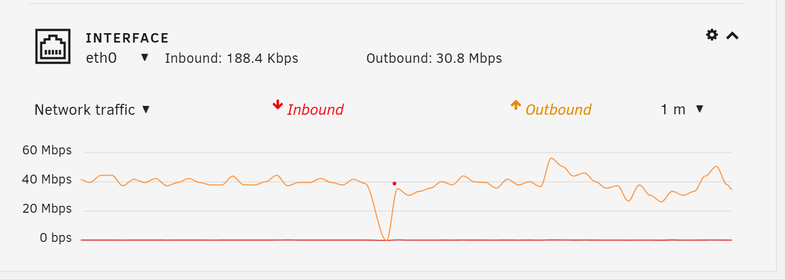

  4. I made the appropriate changes in the BIOS and also tried the "Disable Security Mitigations" plugin. Sadly nothing changed. The processor load during playback is always under 5 %, mostly at 1 or even 0 in the WebGUI. I also tried a Jellyfin install on the Zappiti and the app is not stable at all, so no workaround here. I think my only chance for any kind of improvements are firmware and Unraid updates. Until then I will use the old player for non 4k-files and the Neo with 4k files that are directly connected via an HDD. That's not a great solution but at least my home cinema will be usable again. Zappiti support mentioned that they tested Synology NAS systems extensivly and freezes never occured with a wired connection. I really like Unraid but unless it gets resolved I might need to switch systems. Troubleshooting for several months without any results is frustrating. One more thing: I captured a freeze during Blu-Ray playback, it lasted for around 2-3 seconds. Outbound traffic went to zero, at the same time there was a small increase in CPU load (from 1 % to maybe 3 % or 4 %), then it picked up again by itself (which does not happen with 4k media). As mentioned before, the freezes never occur at the start of playback, it is always at least 10 minutes into it and then happens periodically.

  8. Well, I finally made a direct LAN connection possible. But, as before, the problem still occurs. Pretty disappointed since upgrading the network was a heavy task. At least the drop count remains stable at 0 now. I monitored the network traffic panel during a freeze and noticed something: As the image was freezing, network traffic obviously went down to 0 (from around 100 Mbit/s since I was watching a 4k file) and remained at 0 - 10 Mbit/s. At the same time CPU usage spiked for a second and then went back down. The Unraid Web GUI became unresponsive and didn't update itself while the image on my TV was frozen. Maybe this is a system error? Some kind of HW failure? Going to do a Memtest now ...
