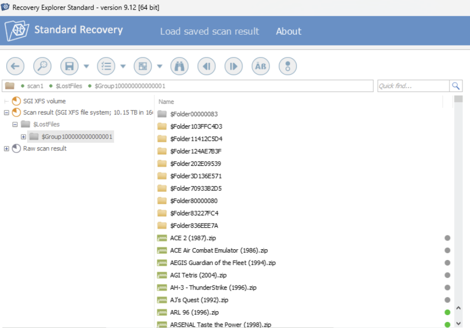

I think I may be able to recover 10TB of data. 🤞. I should probably delete all the ExoDos/RetroeXo files and redownload them after everything is copied... it's ~1.6TB as a set.

Thanks. I did send the broken Disk 7 to Kotor data recovery today, awaiting a free eval. Will await for others about on alternative ideas if there are any. Thanks for the help @trurl .

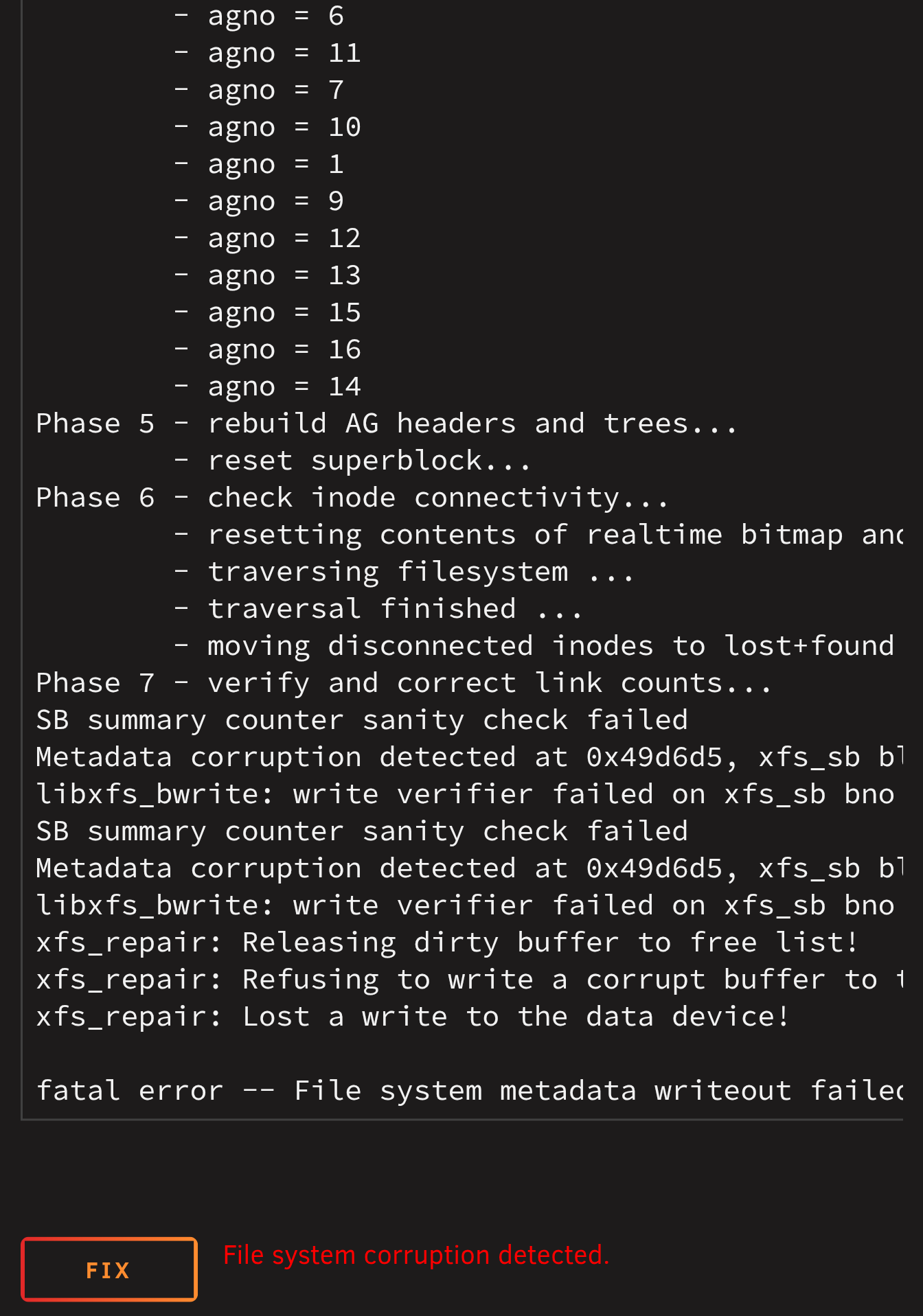

Check Filesystem Status xfs_repair status: Phase 1 - find and verify superblock... Phase 2 - using internal log - zero log... - scan filesystem freespace and inode maps... clearing needsrepair flag and regenerating metadata sb_icount 109504, counted 32 sb_ifree 295, counted 29 sb_fdblocks 1768782218, counted 4394060169 - found root inode chunk Phase 3 - for each AG... - scan and clear agi unlinked lists... - process known inodes and perform inode discovery... - agno = 0 - agno = 1 - agno = 2 - agno = 3 - agno = 4 - agno = 5 - agno = 6 - agno = 7 - agno = 8 - agno = 9 - agno = 10 - agno = 11 - agno = 12 - agno = 13 - agno = 14 - agno = 15 - agno = 16 - process newly discovered inodes... Phase 4 - check for duplicate blocks... - setting up duplicate extent list... - check for inodes claiming duplicate blocks... - agno = 0 - agno = 2 - agno = 1 - agno = 3 - agno = 11 - agno = 5 - agno = 7 - agno = 8 - agno = 9 - agno = 10 - agno = 12 - agno = 13 - agno = 15 - agno = 14 - agno = 4 - agno = 16 - agno = 6 Phase 5 - rebuild AG headers and trees... - reset superblock... Phase 6 - check inode connectivity... - resetting contents of realtime bitmap and summary inodes - traversing filesystem ... - traversal finished ... - moving disconnected inodes to lost+found ... Phase 7 - verify and correct link counts... SB summary counter sanity check failed Metadata corruption detected at 0x49d6d5, xfs_sb block 0x0/0x200 libxfs_bwrite: write verifier failed on xfs_sb bno 0x0/0x1 SB summary counter sanity check failed Metadata corruption detected at 0x49d6d5, xfs_sb block 0x0/0x200 libxfs_bwrite: write verifier failed on xfs_sb bno 0x0/0x1 xfs_repair: Releasing dirty buffer to free list! xfs_repair: Refusing to write a corrupt buffer to the data device! xfs_repair: Lost a write to the data device! fatal error -- File system metadata writeout failed, err=117. Re-run xfs_repair. File system corruption detected.

@trurl https://pastebin.com/LahcVk1g - result of the check. At the bottom of the Check Filesystem Status, there's an option to fix, but I don't know if it'll break it even more so I'll await your input. i also have a flash backup from 12/29/2025 (before LSI HBA issue on Disk 6) if we need to reload the disk.cfg and other settings.

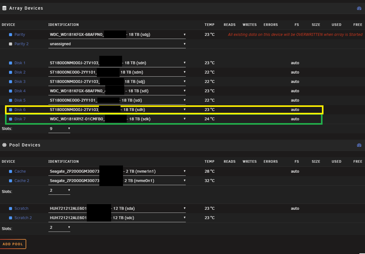

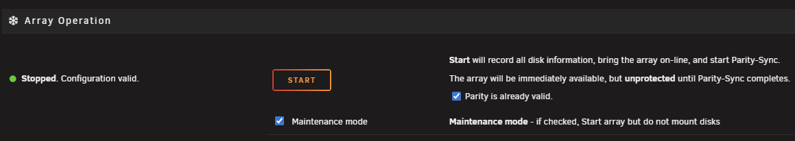

Friends - I have the new 18TB drive (for Drive 7) and new LSI HBA card (ran a quick SMART test to ensure no UMA CRC errors occurs on Drive 6). @trurl - To confirm the process before I proceed, I started created a new config and retained all. I replaced Disk 7 and checked both Parity Valid and Maintenance. Should I be concerned that the red text saying parity will be wiped is still enabled?
