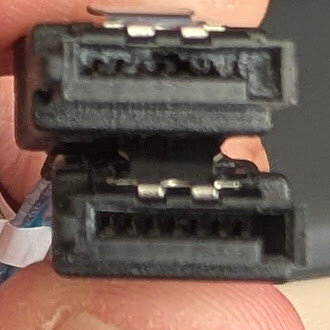

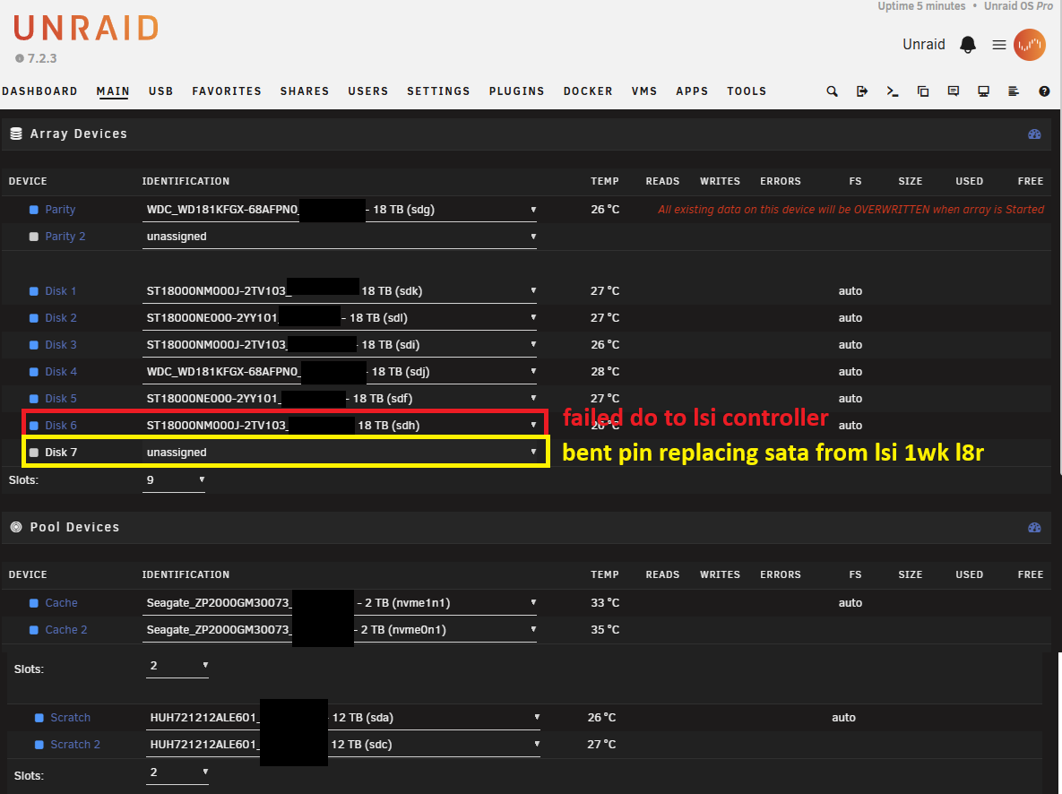

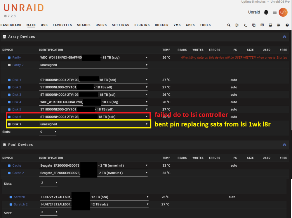

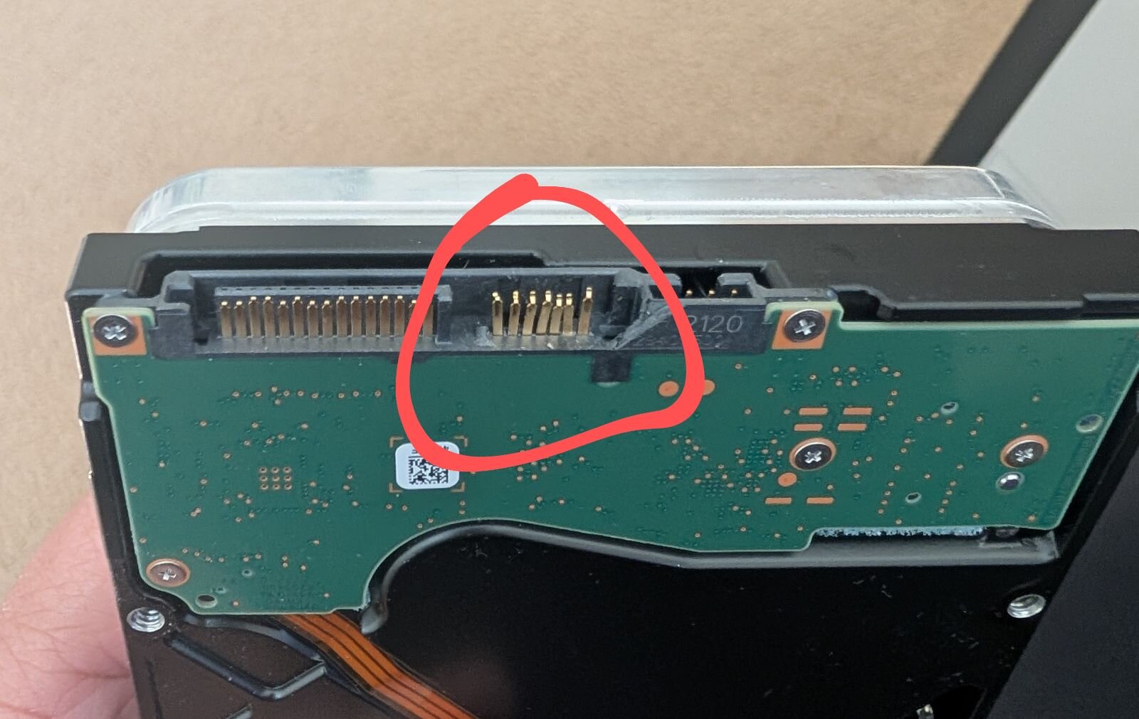

Hi everyone, I’ve managed to get myself into a bit of a corner and need expert guidance before I make things worse. The Situation: Original Issue: Disk 6 (18TB Seagate) showed UDMA CRC errors and eventually went disabled. I suspect the LSI HBA or the SFF-8087 cables, as motherboard SATA ports were fine. The Hardware Accident: While replacing cables and waiting for a pre-clear on a new spare, I accidentally bent/broke the SATA connector on Disk 7 (a completely different, healthy drive). The Software Mistake: In an attempt to "fix" the identification of Disk 6, I initiated a New Config. I realized too late that this invalidated my Parity. I have NOT started the array since the New Config. Current Status: Disk 6: Physically fine (likely just a cable/HBA issue), but Unraid sees it as "New" due to making it offline. Disk 7: Physically damaged connector. I cannot plug it in. Parity: Data is intact on the disk, but the "New Config" has unassigned it. Backup: I have a partial backup of Disk 6, but Disk 7 is NOT backed up. My Goal: I need to recover Disk 7’s data using the Parity drive and the (now healthy) Disk 6. Questions: Is there a way to undo the "New Config" via the flash drive files (super.dat) to restore the drive assignments? Since I haven't started the array, can I use "Trust Parity" to re-assign Disk 6 and the Parity drive, and then let Unraid rebuild the missing Disk 7 onto a new spare? What is the safest sequence to ensure I don't trigger a parity sync that wipes my only way to recover Disk 7?
