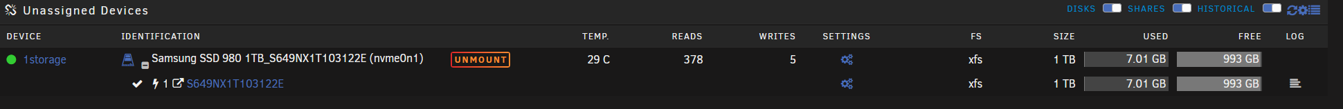

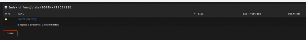

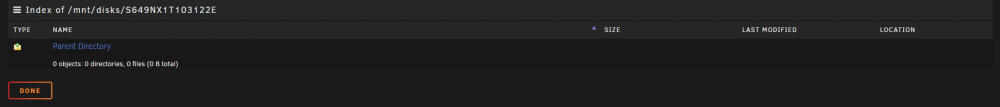

- Unassigned Devices - Managing Disk Drives and Remote Shares Outside of The Unraid Array
I do not get a pop-up. I tried with Firefox and Chrome. This page is where I land if I press that partion link on the main page:- Unassigned Devices - Managing Disk Drives and Remote Shares Outside of The Unraid Array
I just added a non-cache disk to my server and it will give the serial number for it as the default share name. How can I change this? - Unassigned Devices - Managing Disk Drives and Remote Shares Outside of The Unraid Array
