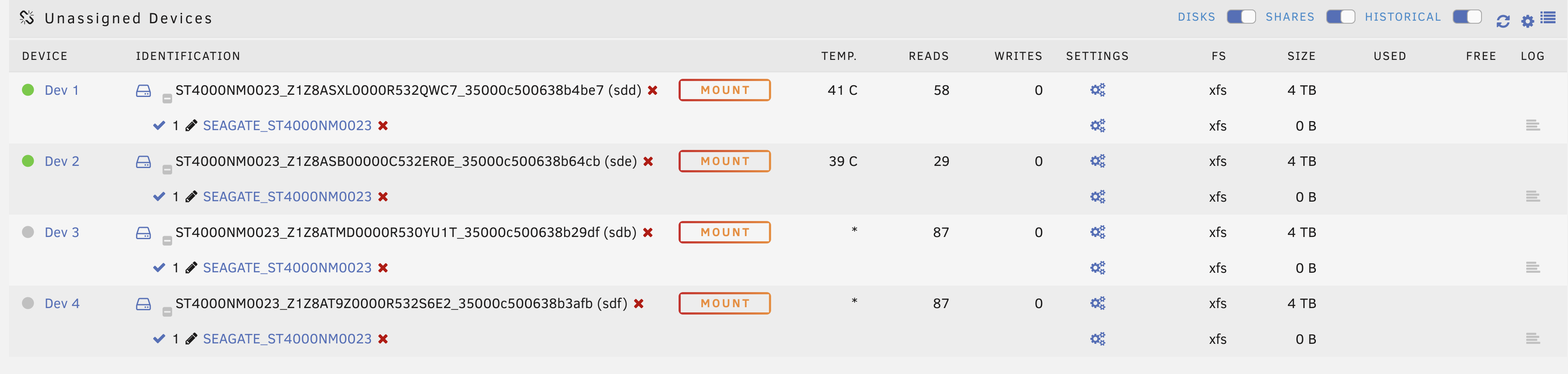

  4. Thanks for the suggestion! When I run this command ("sdspin sdx down") on a spun up device, my log shows this: "SAS Assist v2022.05.25: Spinning down device /dev/sdx" However, the disk doesn't seem to actually spin down. It still shows up as green and with a temperature reading (the spun down devices do not seem to give a temperature reading, which makes sense to me). I attached a picture of what it looks like after trying that command on two of my drives (sdd and sde). The "sdspin sdx up" command works correctly. Any idea what's going on?
