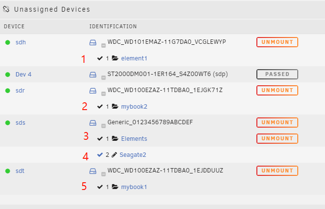

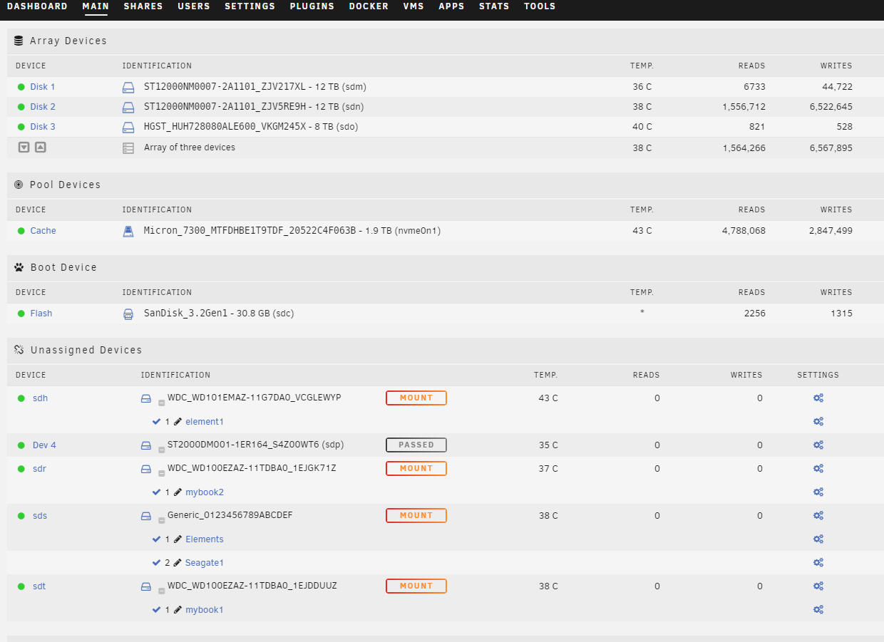

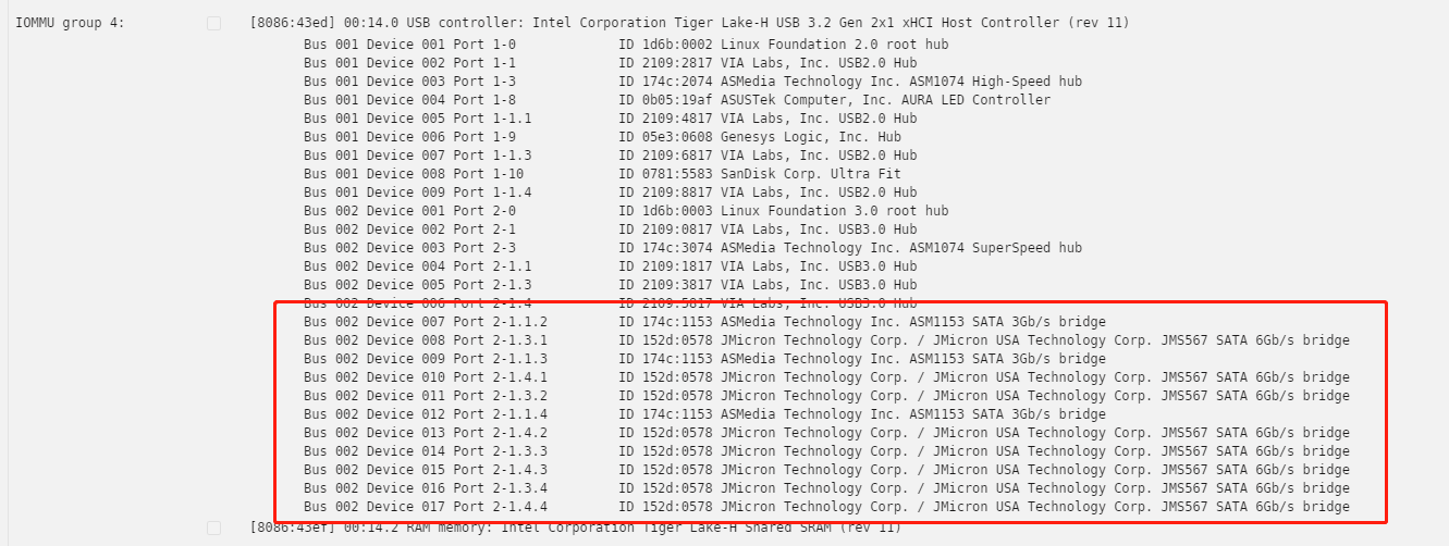

  4. I got 16 disks in total. 4 HDDs connected via Sata, 3 of them are setup in the array, 1 is pass through to Syno. 1 SSD is used as Cache. Other 11 HDDs are connected via usb adapter. The issues is with the 11 HDDs connected via usb adapter., not all of them can be recognized. I can see them in the System Devices. Also I can pass through them into VM by define the Address as below. <hostdev mode='subsystem' type='usb' managed='yes'> <source> <address bus='2' device='7'/> </source> <address type='usb' bus='0' port='2'/> </hostdev> <hostdev mode='subsystem' type='usb' managed='yes'> <source> <address bus='2' device='8'/> </source> <address type='usb' bus='0' port='3'/> </hostdev> <hostdev mode='subsystem' type='usb' managed='yes'> <source> <address bus='2' device='9'/> </source> <address type='usb' bus='0' port='4'/> </hostdev> <hostdev mode='subsystem' type='usb' managed='yes'> <source> <address bus='2' device='10'/> </source> <address type='usb' bus='0' port='5'/> </hostdev> <hostdev mode='subsystem' type='usb' managed='yes'> <source> <address bus='2' device='11'/> </source> <address type='usb' bus='0' port='6'/> </hostdev> <hostdev mode='subsystem' type='usb' managed='yes'> <source> <address bus='2' device='12'/> </source> <address type='usb' bus='0' port='7'/> </hostdev> <hostdev mode='subsystem' type='usb' managed='yes'> <source> <address bus='2' device='13'/> </source> <address type='usb' bus='0' port='8'/> </hostdev> <hostdev mode='subsystem' type='usb' managed='yes'> <source> <address bus='2' device='14'/> </source> <address type='usb' bus='0' port='9'/> </hostdev> <hostdev mode='subsystem' type='usb' managed='yes'> <source> <address bus='2' device='15'/> </source> <address type='usb' bus='0' port='10'/> </hostdev> <hostdev mode='subsystem' type='usb' managed='yes'> <source> <address bus='2' device='16'/> </source> <address type='usb' bus='0' port='11'/> </hostdev> <hostdev mode='subsystem' type='usb' managed='yes'> <source> <address bus='2' device='17'/> </source> <address type='usb' bus='0' port='12'/> </hostdev> The problem is: how can I pass through them to a Docker? I'm not able to define the PATH in docker if UD can't recognize them properly.

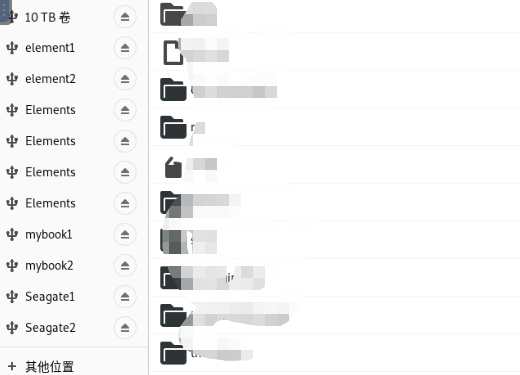

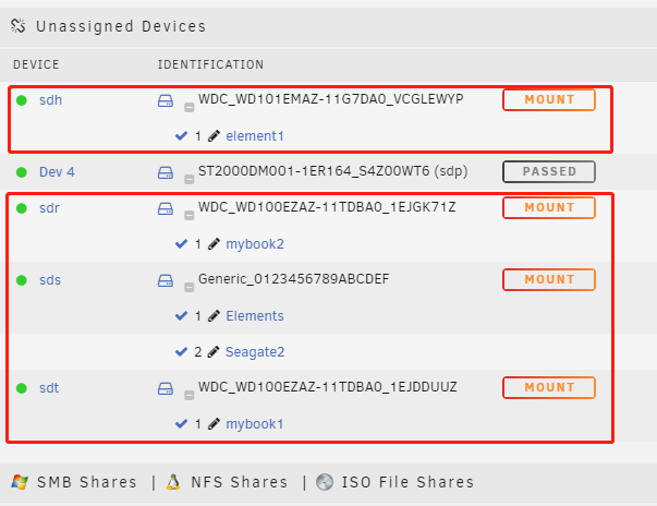

  5. Yes, but only some of them... I got 11 HDDs connented via usb adapters, UD only recognized 5 of them, and only found 4 of them in /mnt/disks/ after 'Mounted'
  6. Hi dlandon, Yes, I'm intended to pass through 'Dev 4' to Syno, this one is not the issue. The others are expected to be 'Mounted' at /mnt/disks/ here are my diagnostics. tower-diagnostics-20210925-0517.zip
  7. I have 11 HDDs connected to Unraid via USB adapters and a USB hub. The USB adapters are from the same manufacturer. They share the same device ID and name. To pass through them to VMs, I have to define the address/bus/port manually. I have done so successfully. The issue is: When I try to mount them via the Unassigned Devices plug, not all the disks are displayed in the UD. The disks found here seem to be random—both the number of them and which disks could have appeared. If I Mount them, then only those 4 or 5 disks(most times 4 disks) can be found in the /mnt/remotes Any help or ideas would be greatly appreciated!

  9. I have 11 HDDs connected to Unraid via USB adapters and a USB hub. The USB adapters are from the same manufacturer. They share the same device ID and name. To pass through them to VMs, I have to define the address/bus/port manually. I have done so successfully. The issue is: When I try to mount them via the Unassigned Devices plug, not all the disks are displayed in the UD. The disks found here seem to be random—both the number of them and which disks could have appeared. If I Mount them, then only those 4 or 5 disks(most times 4 disks) can be found in the /mnt/remotes Any help or ideas would be greatly appreciated!
