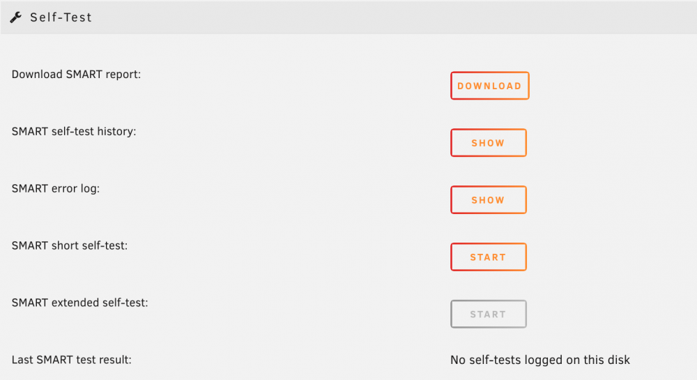

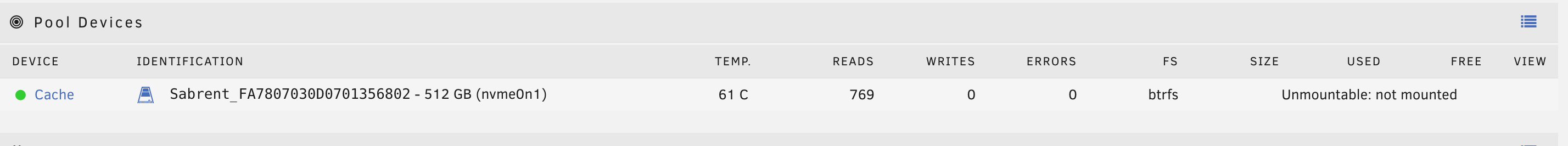

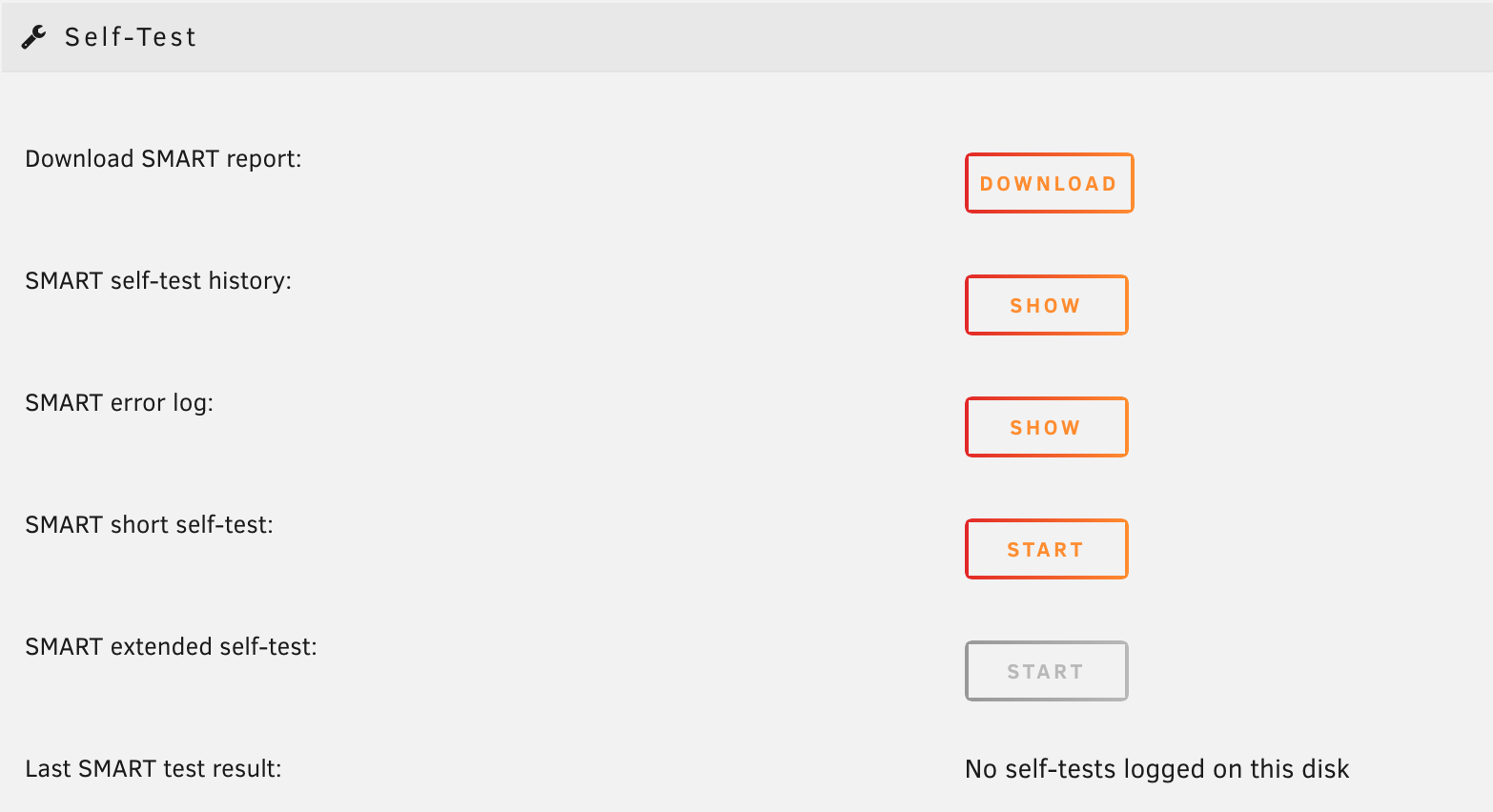

  4. Please see attached. For reference the SSD is currently unmounted due to it stating unmountable. I can reformat it and mount and then supply diagnostics if needed. Someone on the unraid subreddit where I posted this said it looks like the SSD may be failing as it looks like the error count is at 71K. tower-diagnostics-20211007-1222.zip
