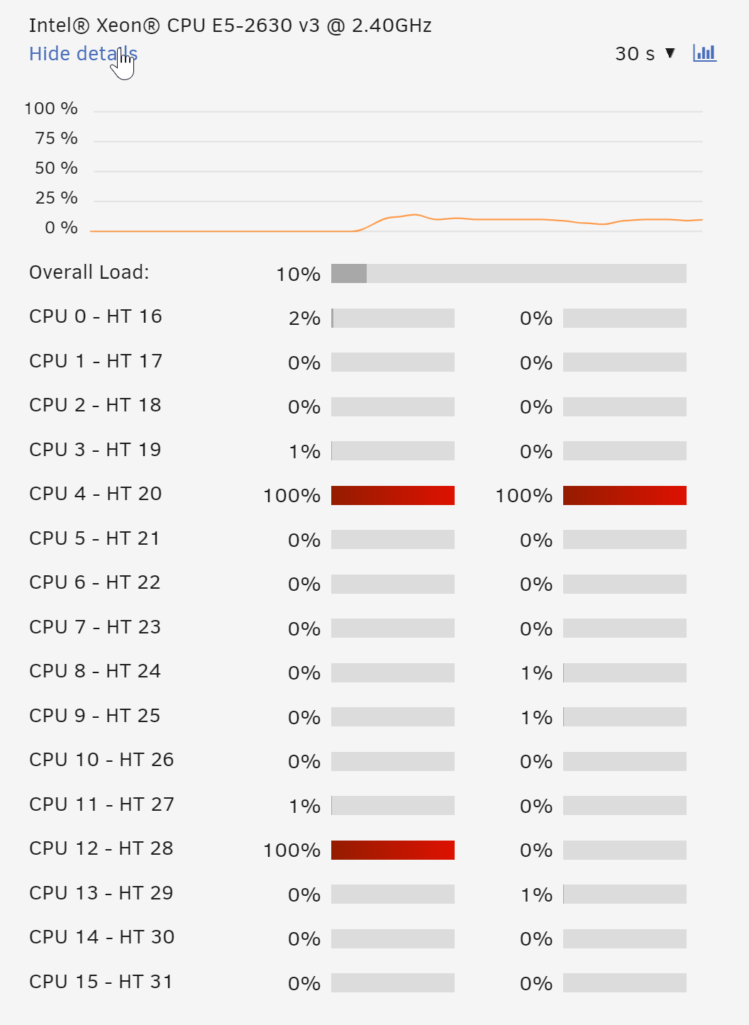

  4. Using Rsync from command line didn't change a thing. I switched to Syncthing and the same issue happens again. I connected the two server directly via a 10Gbe connection, no change, issue happens again. I configured the main server (TrueNas) to send data to a SMB share on a PC -- streams smoothly wth 375 MB/s. The error is on Unraid side and I am quite sure that the error is on system level. Even running the Parity Checker is down to 250 kb/s read/write performance, which is laughable for an internal operation. I doubt its a problem with the SMB - even if I have no hard reasoning besides als Parity check being hellish slow. Anyhow, the system is basically unusable. It was fine with 6.9.2 - things went haywire with 6.9.15. Seems like I have to curb the system and switch so something else, like plain server with MergeFS and SnapRaid. A pity...... but the current state is just inacceptble.

  6. Yes, the RSync procedure was going on at that moment. The SMB performance seemed normal to me. I could access all files on the main server (TrueNas) with good performance (about 800 MBit/s). But RSync reported copy performance of about 3 Mbit/s ... and even worst. between file copy the system takes a break of several minutes. In this time TrueNas idles and Unraid has two cores on 100%. After a reboot, Unraid's docker performace went up from 10min per compose to 10sec again. So something on Unraid must degrade (system was on for 24h before).

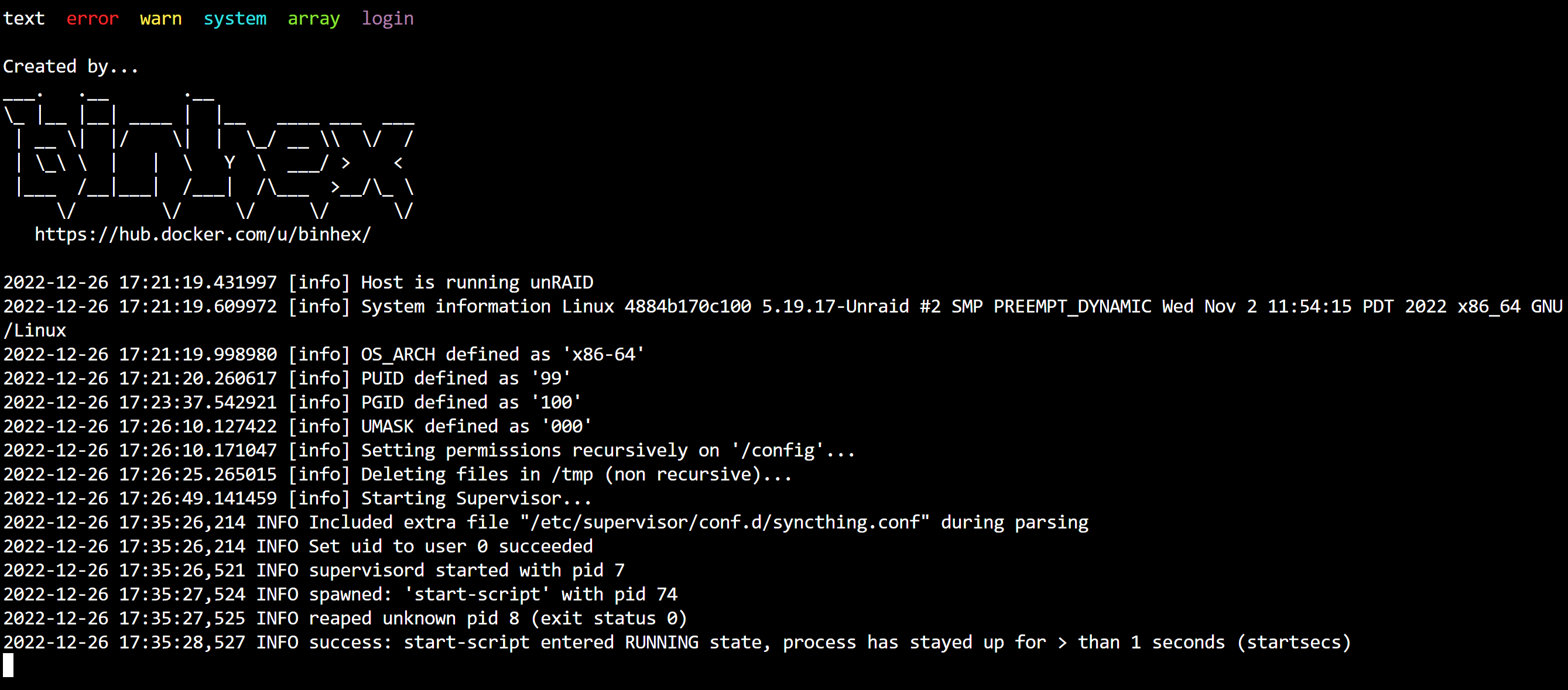

  8. Freshly created. Edit: Added snapshot of startup performance of Syncthings (see timestamps, its crazy) mainbackup-diagnostics-20221226-1720.zip
  9. Hi I am using the latest Unraid Version (06.11.05). Since a couple days I have massive performance issues. The copying of data from the main server (TrueNAS) via RSYNC suddenly is slow as hell, in the area of kilobytes. For minutes nothing happens, before it bursts shortly. I tried to switch to Syncthings, but then noticed that even the docker run command for it takes 1h (!!!) to complete. The system is slow as hell. During the docker run also the entire server is not responding to nothing anymore. A complete catastrophy. The software is basically unusable. No changes to TrueNAS or anything else in the network. Need help or I have to curb this thing. Its supposed to be a smooth working backup and not a maintainance hell. Best Regards
