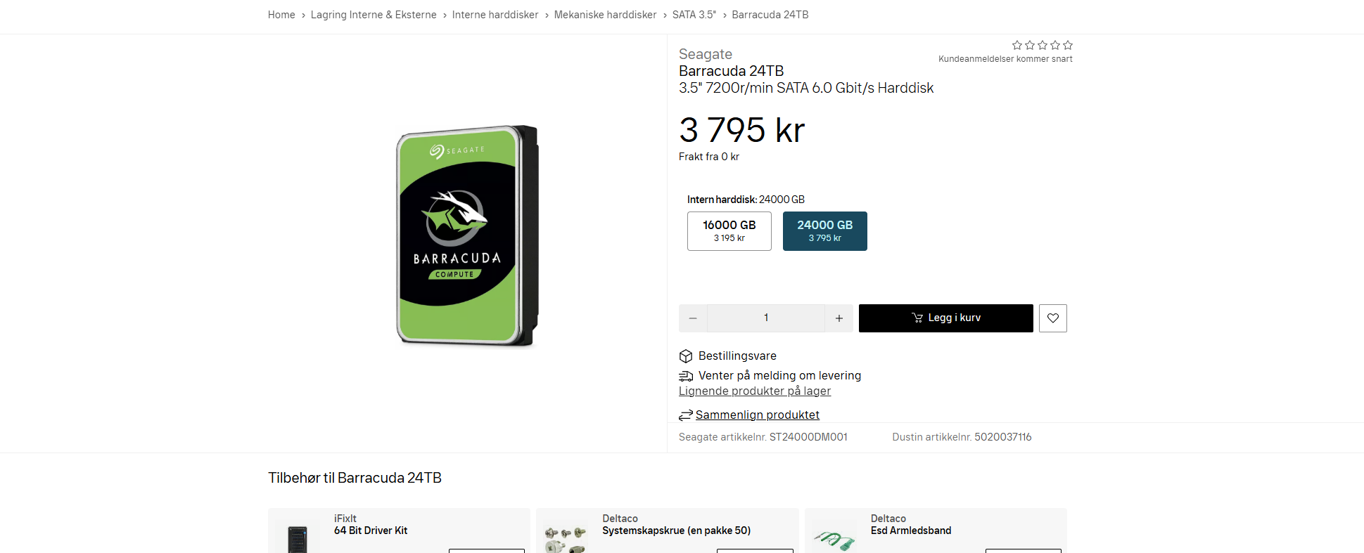

  9. found a good price on these "ST24000DM001", and want to have a backup of the server on a couple of these but im a bit worried about the yearly power on hours rating? will they be good as a sort of cold storage only being connected for backup once a month or so or does the power on rating not really matter if they are connected but not spun up?

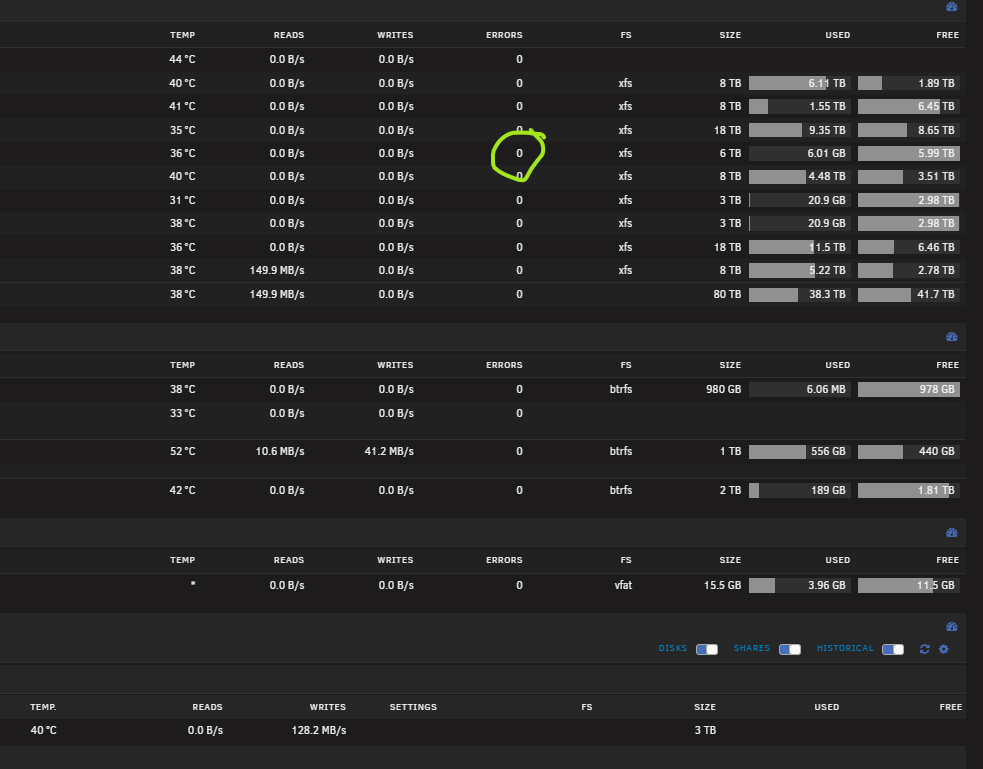

  10. what could be the reason for this? is the drive safe? a disk i had this problem with before and removed from the array and precleared ended up not doing this when i put it back in the array and have worked since. but that was a 3 tb, this is a 6tb and i dont have time right now to do this. any ideas?

  12. i guess i could put it back in there and pull some diagnostics but it does get detected and listed in the device list etc
