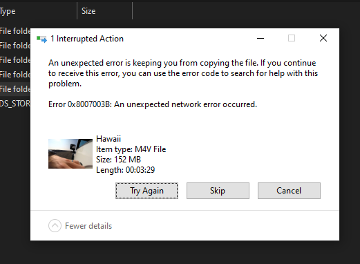

  1. Same problem here. My system is strong enough, however I get IOWAIT up in the 50-60% ranges.
  2. What did you do to resolve your issue? I am having the same thing.
  3. Whatever I did fixed the problem. I went into my plugins and removed some that I don't use or didn't have any use for. I don't know if one of those plugins was causing this problem, or what, but I can not write to the server just fine. Thanks for helping!
  4. Hmm, thanks. I cleaned it up. I don't know why when I posted the zip it posted the other files separately. Thank you!
  5. Okay great - I'll send it over! I wasn't sure if you wanted everything. tower-diagnostics-20220716-1329.zip
  6. Thank you for such the fast response! I am still new to Unraid and am not very proficient yet. What specifically in my network should I look at? It has the same result with any file size. For the diagnostics file, which file in the extracted folder do you need specifically? I notice there's some sensitive information in it. I attached the syslog that the diagnostic report created below. syslog.txt
  7. Gruffydd changed their profile photo
