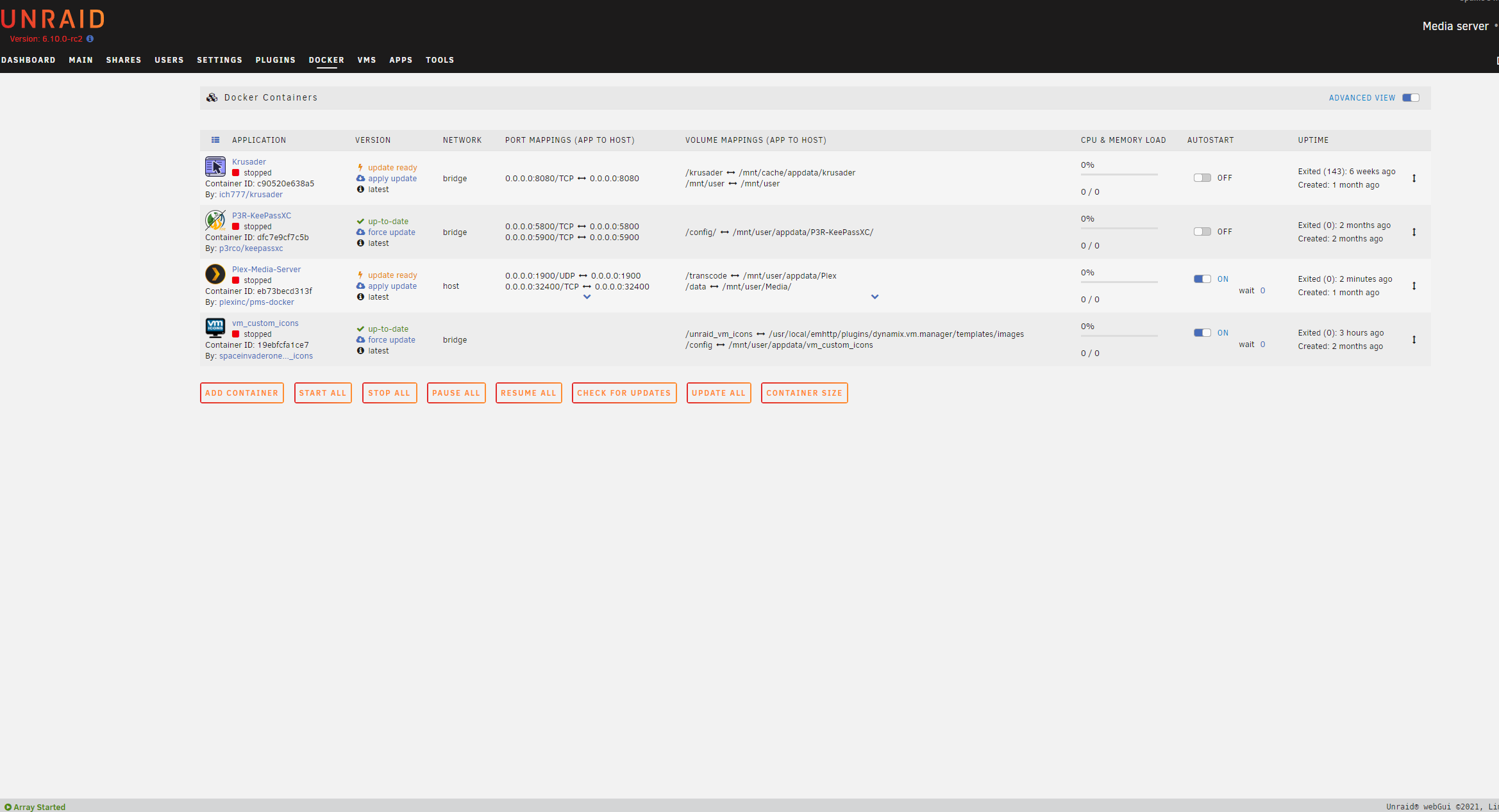

  4. Hi, Thanks for offering help. I have disabled VPN on router and passed the test. But still cannot access remotely.
