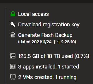

I configured my router with a VPN service so that all the traffic will be through the router with an external IP address that match my VPN server. But the problem with this is the unraid read the incorrect WAN IPv4 address, which is not ISP address but the VPN server address. I set up the port forwarding in the router, yet it shows server unreachable. How can I fix this?
The attached picture shows the IP address of the VPN server.

I noticed your screenshot says "Local access". To change that to "Remote access", you need to be on a different network than the server (or more exactly, you need to have a different WAN IP than the server does). Then the dashboard will offer you the Remote access link.
