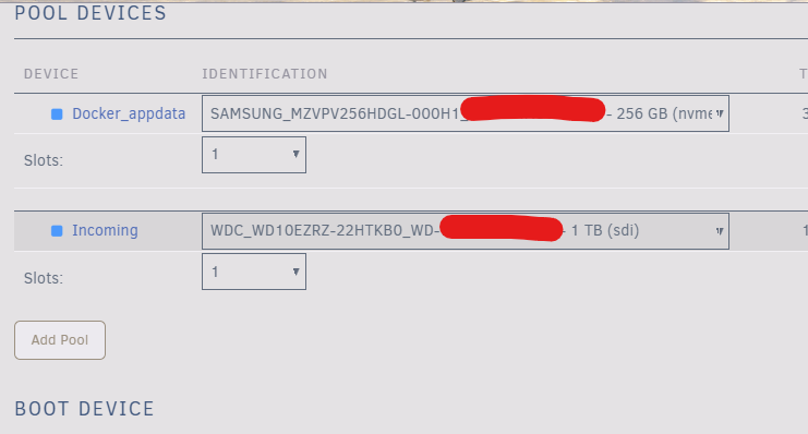

Pool devices are unassigned after reboot
Hello, as per the title two of my pool disks were unassigned after a reboot, one is my docker_appdata nvme and the other one is a download cache sata disk. Both devices show up under unassigned devices. Is it safe to reassign them to their respective positions with no risk of losing data or is there anything else I should do? Thanks. unraid-diagnostics-20250213-1013.zip

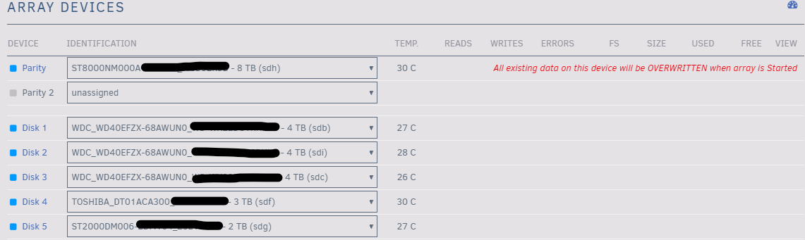

Reassigning the second Parity Drive as a Data drive
Hey, my setup has 2 parity drives, I want to reassign the smaller one as a data drive. Followed the below instructions : 1. Stop the array 2. Select Tools >> New Config >> Keep Pool assignments for ease 3. Unassign the smaller parity drive 4. Assign the drive from step 3 to a Data drive slot 5. Start the Array 6. Wait for the Format to complete At this point I am at step 4 and I'm facing the attached image. Do I continue with step 5? Thanks.
