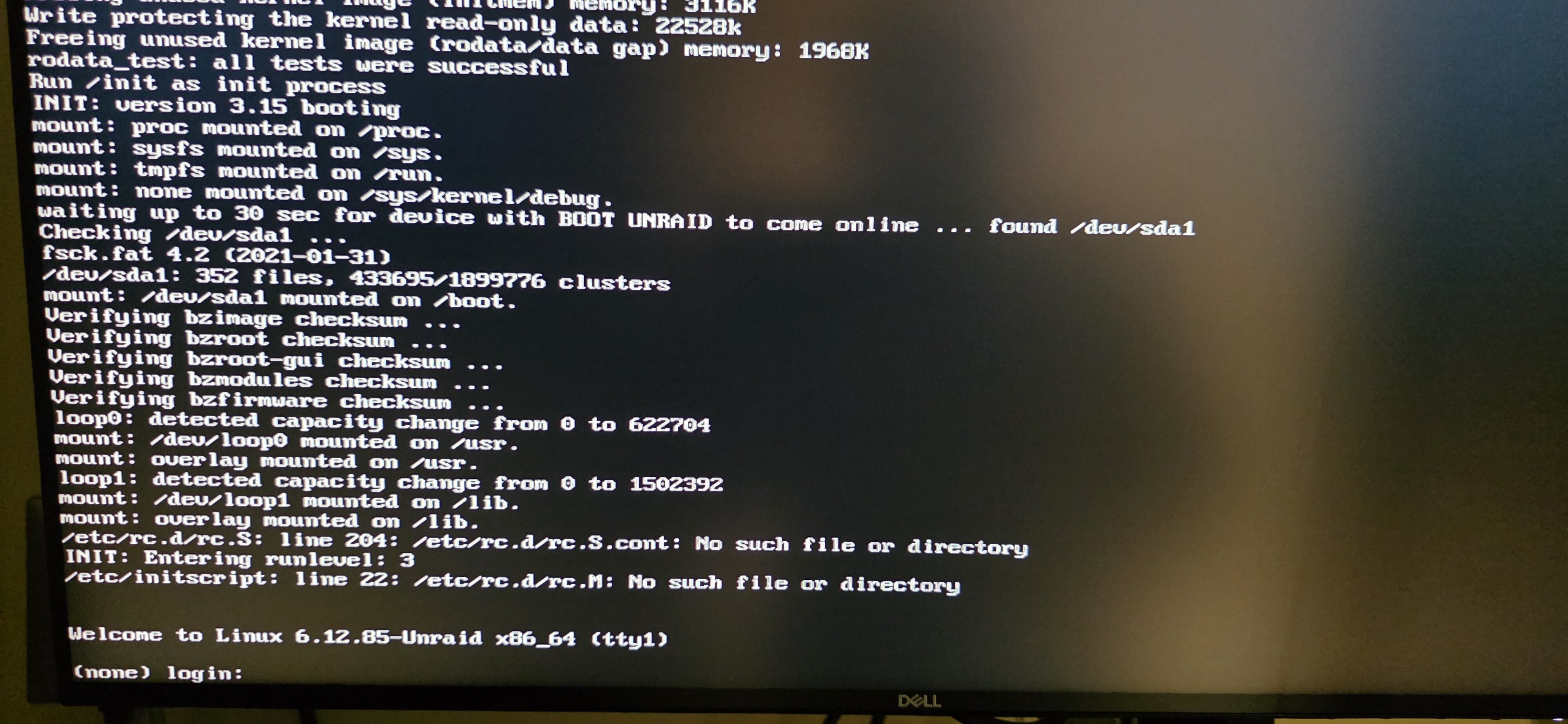

  2. I did what you have suggested and it worked like a charm.. even though I have tried it before with 7.3 and got the same result as the picture above. So I thank you very much. After a successful start, now the cache drive showing "unmountable wrong or no file system" Now is the fear from moving to internal boot.. I hope I don't mess it again. absnas-diagnostics-20260531-1331.zip
  3. Hi, I have a BIG little problem and I know it an easy issue for the experts, which I am not. I F'ed big time when update my Unraid to 7.3 I updated my system to 7.3 and selected the internal boot drive, an old 250 GB 2.5" HDD. The USB boot drive disappeared and there was a boot pool. I removed the USB flash drive, and the system won't stat. I removed the boot pool and the system wont start with the USB flash in. I downgraded back to 7.2.5 and every time I try to upgrade the WEBGUI won't start and I get "Welcome to Linux 6.12.85-Unraid x86_64 (tty1) (none) login:" That is it and it won't recognize my root credentials. Nothing would work from here. I still have my flash drive backup. Is there a way to upgrade using new flash with 7.3 and then restoring my configuration from my backup??
