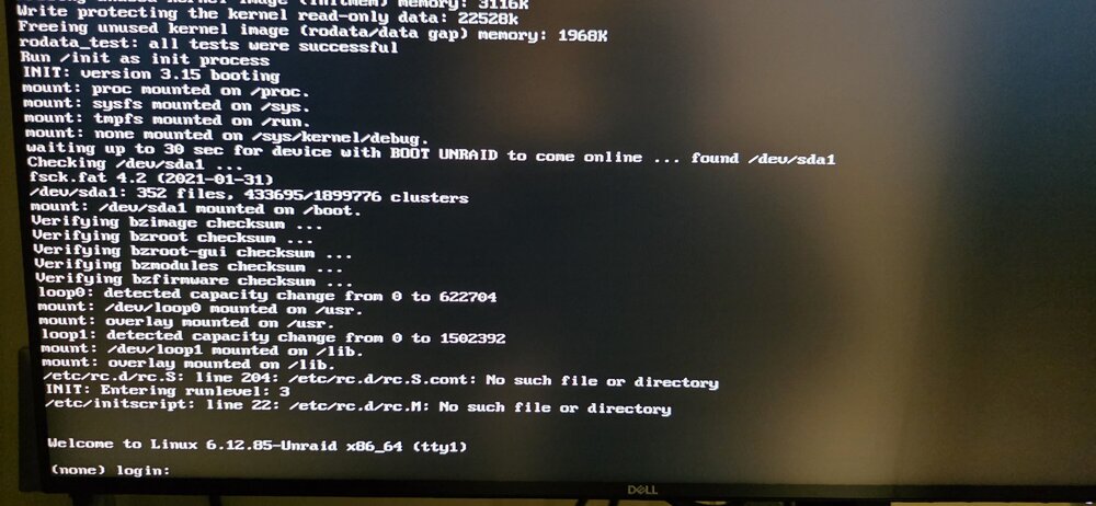

I downgraded back to 7.2.5 and every time I try to upgrade the WEBGUI won't start and I get "Welcome to Linux 6.12.85-Unraid x86_64 (tty1)
(none) login:" That is it and it won't recognize my root credentials.
Nothing would work from here.

I would suggest creating a new 7.3.1 flash drive using the USB Creator and check it boots. At this point it will be a virgin install with no licence.
You can then restore the config folder from the backup to get all your settings applied and reboot. If this step fails then it probably means there is an issue with the contents of your 'config' folder in the backup so if that turns out to be the case I suggest you come back here describing what is happening, ideally providing a diagnostics.zip file so we can see what the current state of things actually is.

I did what you have suggested and it worked like a charm.. even though I have tried it before with 7.3 and got the same result as the picture above.
