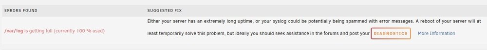

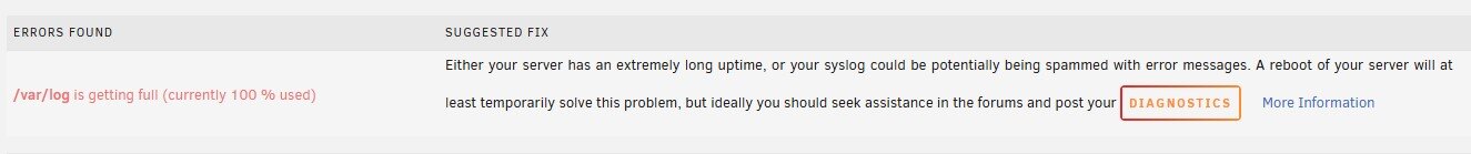

  8. I keep getting this error and I don't know how to fix it. embyserver-diagnostics-20240615-1028.zip
