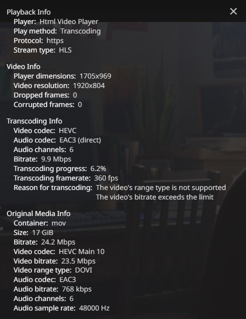

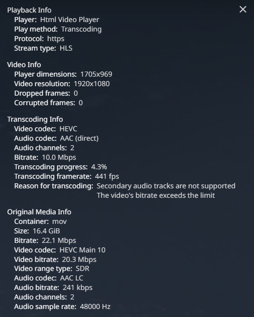

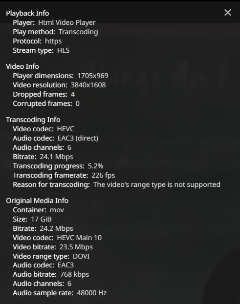

  18. 14th Gen Core seems to be the best choice for you. But without the VRAM cap the ARC A770 LE 16GB can do even more than iGPU. I use AMD APU on my server because it is energy efficient. This prompted me to choose ARC and enable ASPM in BIOS to avoid high power consumption at idle state. 130 bucks, MSI low profile A380. I don't gaming on it so it fits my use case perfectly. What I said is DG2 can match x265 software encoder at "medium preset" as per the slide from Intel. With slower presets I think x265 encoder is still the best but the FPS can be very slow even on modern processors. Yes but not quite, I also made some tweaks to Jellyfin's FFmpeg to unleash its fullest potential on both Linux and Windows. Yes, on supported clients such as Android App and Safari the HEVC->HEVC transcoding is supported out of the box. I used MS Edge with our web client preview for the FPS demonstration.
  19. Sure. But I don't have an ETA on it.
  20. It seems you don't understand how hardware transcoding works. Here's the main steps: Read Video.mkv => Demux => Raw HEVC bitstream => HW decoder => Decode frames to VRAM => Apply HW scaling/deinterlace/tonemapping filters in VRAM => HW encoder => Encode frames from VRAM => Raw H264 bitstream => HLS/DASH muxer => Write to your transcode temp folder => Play in your browsers and clients For high res content such as 4k the "Decode frames to VRAM" step costs VRAM a lot (800MB~1GB per video). So I was not talking about the capacity of your /tmp folder or RAM. It doesn't help the VRAM that used by HW decoder. Use RAM as the backup of VRAM at driver level is feasible but it is extremely slow, which involves too much memory copy-back between your VRAM and RAM through PCIe. Resizable BAR doesn't help too in this use case. That's why VRAM on high-end dGPUs is getting bigger and bigger. It seems Plex don't have plan to transcode to HEVC any time soon from their last reply in r/plex. I write code for Jellyfin so I added the HEVC encode back in 2020 and I use it for myself to save bandwidth.
