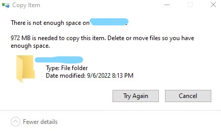

  18. Copying a few things over to test as I am just getting this up and running finally. I keep getting this out of space error when I have space on the HDD. There is hardly anything on it. I am using Windows Explorer to drag and drop it from folder off my computer to the server folder. What am I, or setup, incorrectly?
