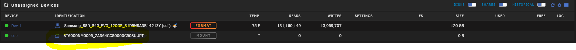

  1. Hi guys, I have two 6T Seagate Exos SAS drives that I have connected. I did purchase them from two different places on EBAY. One of my drives showed up perfectly and was able to be formatted. The other shows up in Unassigned Devices, the mount button is grayed out and it shows 0B for the size (see screenshot). I found in the logs where it says 512 - byte logical blocks, so I don't think it is that 520 size issue with SAS drives... I have attached the diagnostics if someone could please take a look at it and see if you can find what might be happening. Thanks! valhalla-diagnostics-20220214-2005.zip
