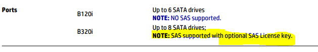

I have read that I need an HP Smart Array SAS License Key installed to provide support for SAS Hard Drives? Any ProLiant MS Gen8 users out there that might be able to confirm and help me if this is true?

Do you have the optional SAS license?
I am trying to figure out what that is, and how to get it. Any ideas, or have you heard of that before?
Ok, so I have researched and if I purchase an M1015 SAS/SATA Controller (https://www.amazon.com/IBM-Serveraid-M1015-Controller-46M0831/dp/B0034DMSO6), I can just disconnect the mini SAS cable from the port on the motherboard and plug it into one of the two mini SAS ports on the card. This will instantly allow my SAS drives and SATA drives to work. This will also give me the capability of adding 4 more hard drives.
