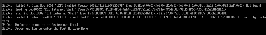

Can't get unraid to boot in pve 8.3.0
If I create an EFI disk like proxmox wants (which seems to be part of the issue, i get the following screen:

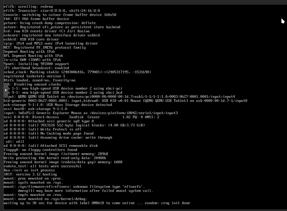

Hello All, have a fresh install of pve and an existing unraid setup, trying to port the existing bare metal unraid setup to a VM. USB thumb drive pass through appears successful, however it fails when attempting to unmount / this happens with legacy or UEFI mode, though with UEFI mode, I have to manually navigate into EFI-/boot from the UEFI shell to get it to work. i have tried all of the usb ports (including usb 3 and 2) to no avail. edit: the screenshot is cut slightly, but there isn't really more information, it fails to unmount / and then says 'not found - press ENTER key to reboot'
