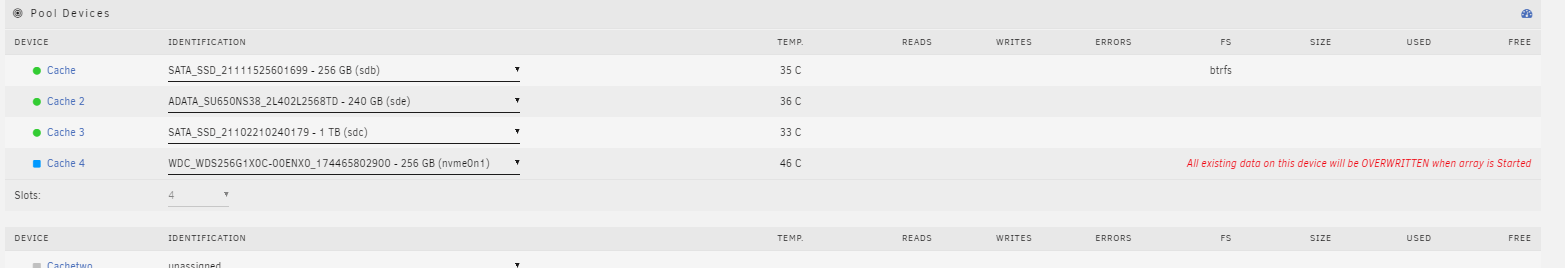

EDIT: Whoops. Definitely not fixed. Getting Fix Common Problems Errors "unable to write to cache" and "unable to write to Docker Image" I was re-reading some other posts I had pulled up earlier where @JorgeB recommended to another person that the way to address the "All existing data on this device will be OVERWRITTEN when array is Started" warning if you sort of mess up a drive config is to un-assign everything, start the array, stop the array, re-assign. I did that. Then, I figured I'd try to start the array, and the cache pool started totally fine? I then went back and re-enabled Docker and VM Manager and the docker service started, as did the cache. But now I have to figure out what broke here. castle-diagnostics-20250204-1005.zip

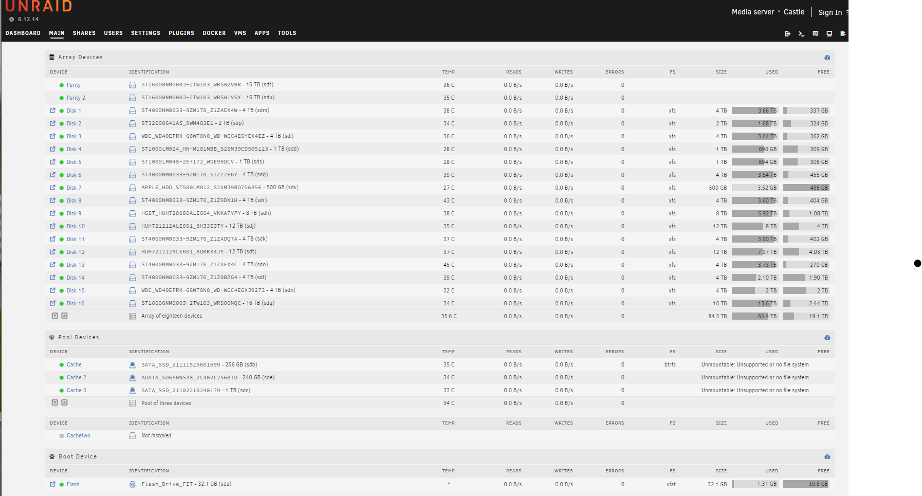

root@Castle:~# btrfs fi show Label: none uuid: bbe1c830-2781-400e-8a8e-6dda9da14c36 Total devices 4 FS bytes used 841.49GiB devid 1 size 238.47GiB used 154.00GiB path /dev/sdb1 devid 3 size 223.57GiB used 134.00GiB path /dev/sde1 devid 4 size 953.87GiB used 499.03GiB path /dev/sdc1 devid 5 size 238.47GiB used 150.00GiB path /dev/nvme0n1p1

Hey folks. Looking for some help here. Overnight, all my dockers crashed. I poked around a bit and figured I'd just reboot the server to start. After reboot, my cache wouldn't mount. Getting an error that says "Unmountable: Unsupported or no file system" I had one cache NVMe SSD that seemingly wouldn't generate a SMART report, so I removed it from the cache pool and tried to start the array, but got the same error. Now, when I try to add it back, I get the "All existing data on this device will be OVERWRITTEN when array is Started" warning. I do not remember how to resolve this, but figure I should before I tackle whatever caused my overnight issue. My presumption is that no data has been modified on these drives since they can't mount, so perhaps there is come config thing I can do to re-establish the 4 drive cache. No hardware or other changes in months. I've just been plugging along for a while now. As you can see, the drives here are a gross mishmash of all sorts of stuff. Posting both diag with the array stopped and after trying to start it with 3 of the 4 cache drives listed. __819 is without the array started. __823 is with it started but that 4th cache drive not selected in the pool so I don't accidentally overwrite something if I can avoid it. I would appreciate any help! castle-diagnostics-20250204-0819.zip
