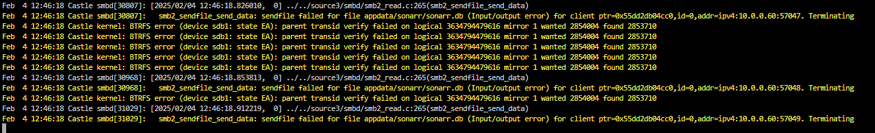

I'm looking for some advice on the least disruptive way to go about this. I at least know just enough to be aware that my appdata folder and my Docker.img file live on my cache (lol). I thought I could be cheeky and just switch all my shares to go from cache -> array then run the mover, but that indeed yields about a million errors. Or, for example, attempting to copy my sonarr.db file yields this. Annoying!
Is there any simple way to attempt this? Add another 1TB drive to the cache, somehow balance everything to shift to that drive, then remove the other drives? Presumably, these files are the ones that are borked and this error would persist.
Or, alternatively, can I mount these drives in the UD interface and back up these files that throw errors? I know that risks some data corruption if the files themselves are borked, but is this a good idea to do? I think I'll be permitted to copy the files, and it's not like I have mission-critical info here if some of the individual files are corrupted.
