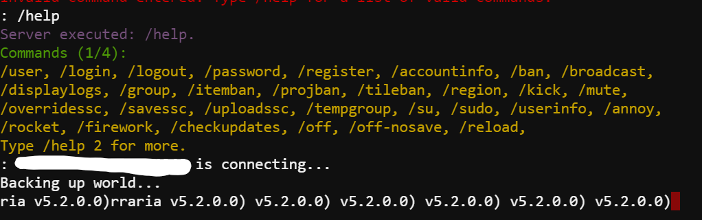

  2. This happens "all the time" more or less. The server seems to write out some status message about the number of players / world name / IP:Port on a fixed interval. I do have mods currently. Vanillafied and Protector. I just tried it with a second unmodded container and got the same results. The behavior when hitting return is inconsistent. Sometimes if I hit return it will immediately react, usually by telling me that the command I entered was incorrect even if I didn't type any text. Sometimes it hangs and doesn't do anything for a while until the next status message is written. It will un-hang if all players exit the server though. I noticed that the status output thing only happens if a player is in game. Otherwise the console seems to work fine. If you can't replicate it, I can live with it. It's fine enough to run commands in game for me.

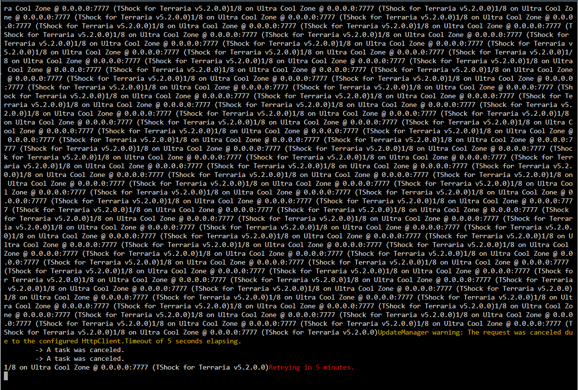

  4. In regards to the Terraria Tshock server: For me the formatting of the WebUI ocassionally gets messed up in a way that makes me unable to send commands over the WebUI. I'm not sure what the issue is but my guess is that some message is getting sent with formatting that breaks the WebUI. The second picture is from the container's logs. It's clear something has gone wrong but I am not sure what and I'm unsure of what to do about it.

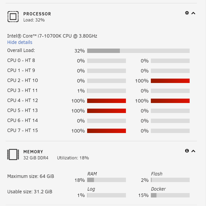

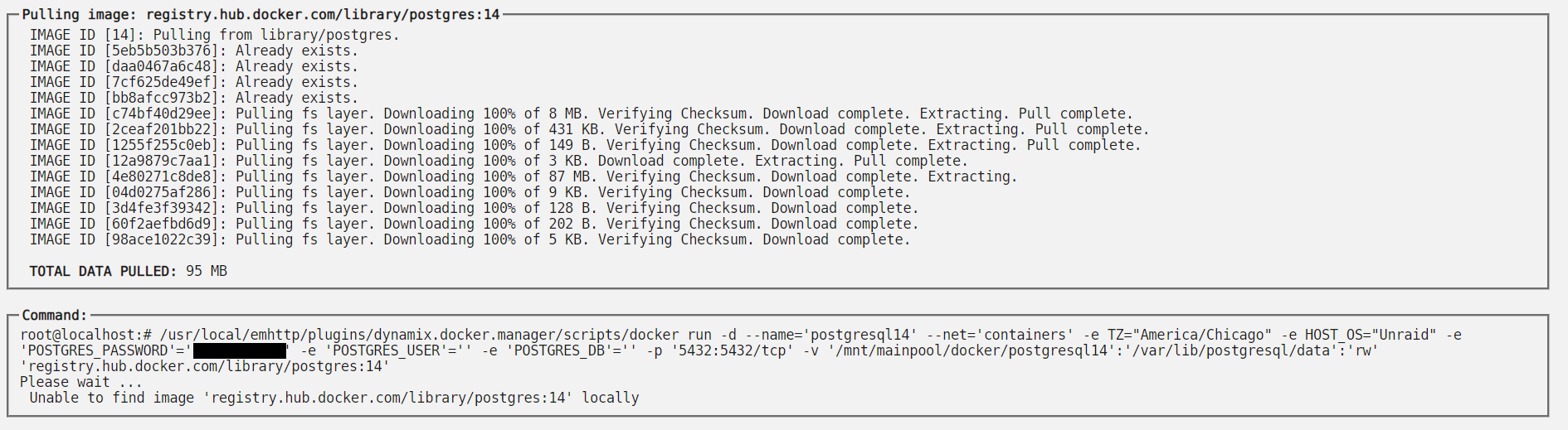

  11. Hello and thank you in advance. For some reason, after removing a docker container, my Unraid instance is a bit broken. I'm not sure if removing the container is what did it, but that's when I noticed the issues. I'm attaching a couple images. One is what the add container UI shows, and the other is a screenshot of the CPU usage after trying to add the container. Before adding the container CPU usage was minimal. nas-diagnostics-20220227-1352.zip
