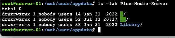

  5. this is what i got. you have any idea why is it different?

  7. it didn't work. i tried securing the plex share and a regular share, non of them worked
  8. do you have any idea where can i check the premissions? because non of my shares are secured and i have no idea how to set a premission to docker app

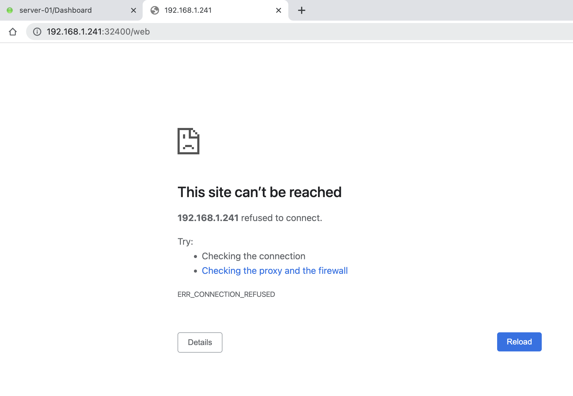

  9. 192.168.1.241:32400/web/index.html#! this one dosent work. same error page. and i will post here the diagnostic. thanks for the help server-01-diagnostics-20220926-0012.zip
  10. Plex-Media-Server. the official one. i tried reboot the system and the docker app. didnt work
  11. hello. since upgrading unraid to 6.11.0 plex just stop working. it is up to date and still i cant access the webui or log to plex from any pc in my lan. is anyone have a solution?
