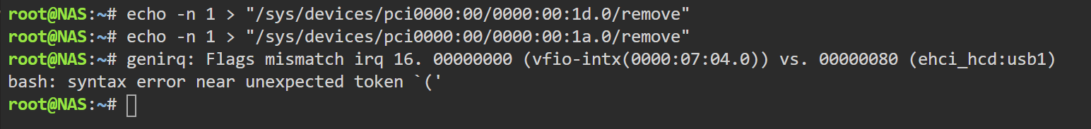

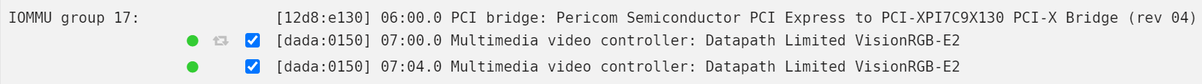

  5. THAT WORKED!!! - Rebooted with the USB stick in a USB 3.0 port - Ran the first remove, still got the error. - Ran the second remove and it booted with one input enabled. It wouldn't boot with both inputs enabled. Not a big deal, but I wanted to try your fix anyway and I got a syntax error. Did I somehow copy and paste wrong? I'm accessing the terminal through a browser on Windows, so that might be causing issues. I posted the terminal window and error after trying to boot with both. This is the one bit I'm unclear about: I removed them from "vfio-pci.cfg" (as opposed to just unchecking in the GUI) and rebooted. When it came back up, they were unchecked in Tools/SysDevs, but still showed up in the VM config. I made sure only one input was checked off and got the same error. I ran just the second command again (echo -n 1 > "/sys/devices/pci0000:00/0000:00:1a.0/remove") and it worked. So, do I have to manually run command that every time I boot UnRAID? Totally cool if that's the fix, I just wanted to double check, cause it feels like I missed something. Thanks so much for your help! You've given everyone with a Datapath Vision hope to use it in UnRAID...and that's a lot more people then you'd think!!

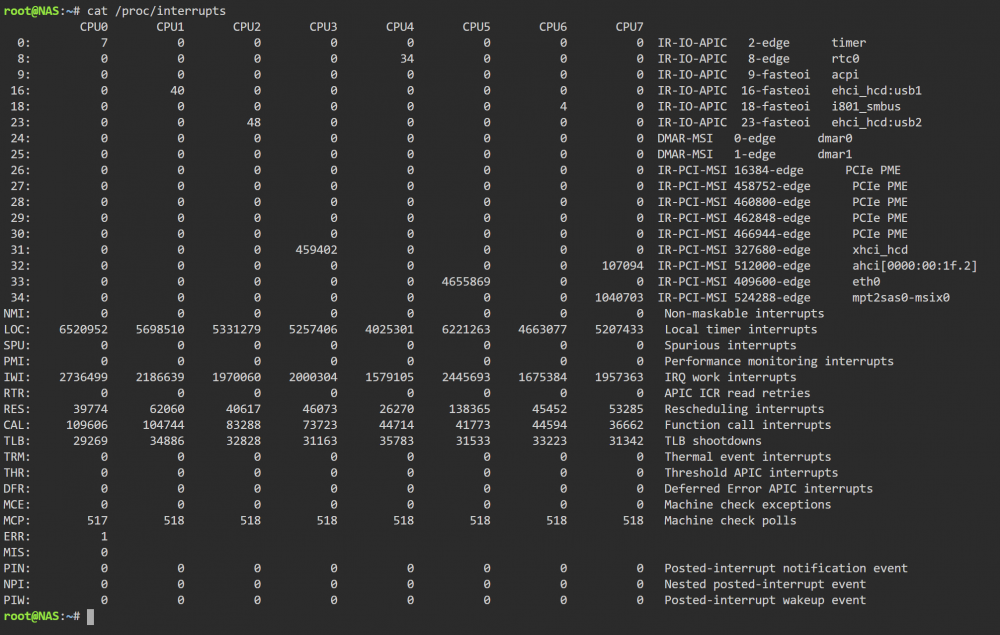

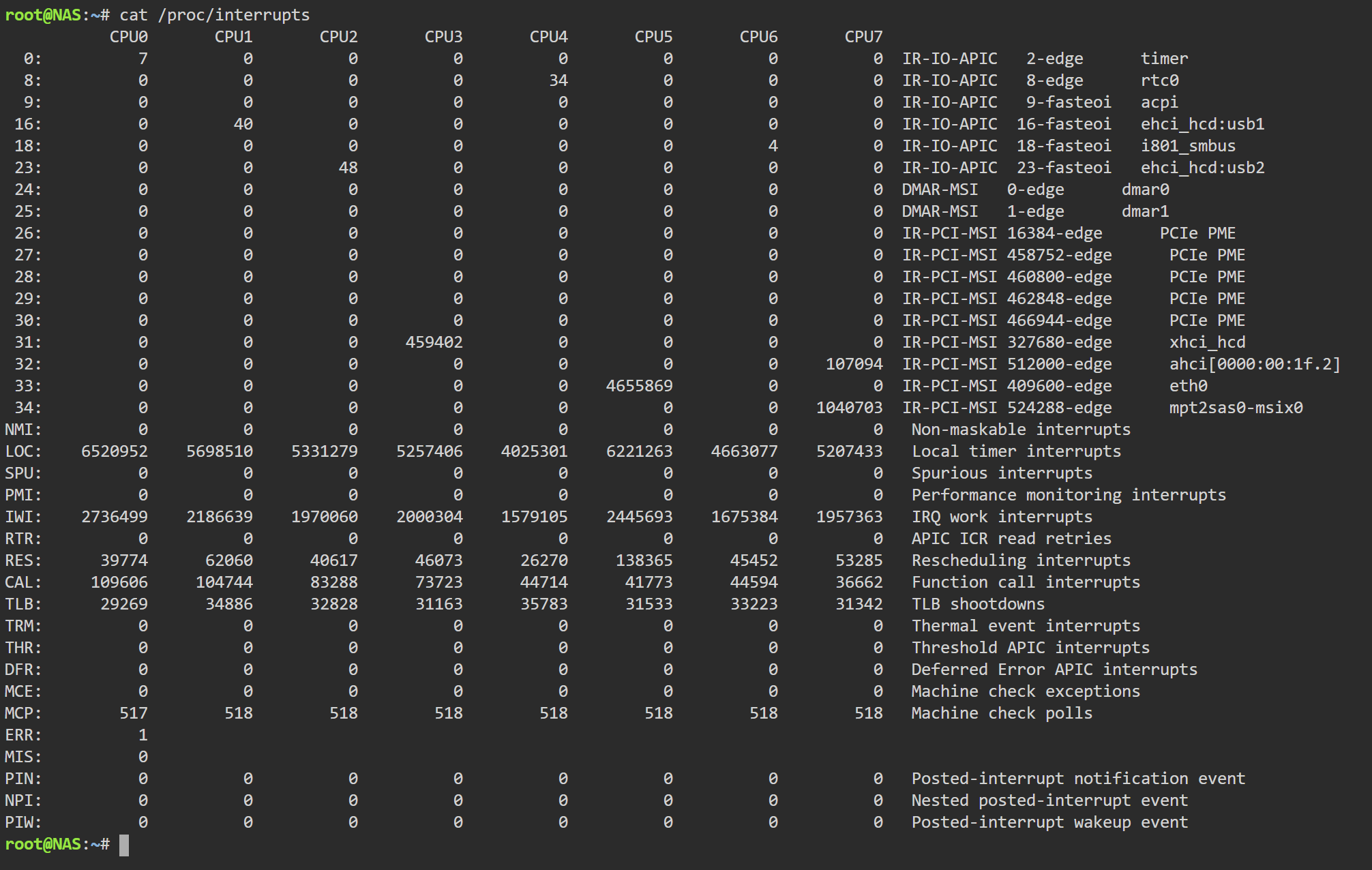

  6. Thanks very much for the response. I know what IRQ's are, but to be honest, I haven't had to worry about them since the 90's...and never in Linux. So, I'm almost worse than a newb, cause I have all that DOS/Windows experience confusing me. I ran "cat /proc/interrupts" and got the attached results, which is not what I was expecting. I'll do some more research and follow back up if I have any luck. ...and if there's any UnRAID experts here with a Datapath Vision card, maybe you can lend a hand?

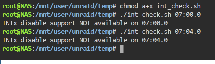

  7. Thanks so much for the help! I ran your script and got the following on both; It's a *dual-input card, but shows up as two separate cards: INTx disable support NOT available on 07:00.0 INTx disable support NOT available on 07:04.0 Would the next step be to check IRQ settings in the BIOS, or is it something I should be checking in the UnRAID configuration? *The only times I was able to get it working previously, I could only have one of the two enabled, not both. That would be an acceptable solution (and certainly better than nothing!), but having access to both would be ideal.

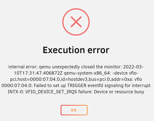

  8. I've had mixed luck getting Datapath Vision E1s (or E2s) PCIe capture cards to pass through to an UnRAID VM. Other cards work fine, but I've tried this model via multiple slots on multiple machines and while I've occasionally found a combination that works, I mostly just get this error: internal error: qemu unexpectedly closed the monitor: 2022-03-08T19:37:22.659750Z qemu-system-x86_64: -device vfio-pci,host=0000:07:04.0,id=hostdev0,bus=pci.0,addr=0x6: vfio 0000:07:04.0: Failed to set up TRIGGER eventfd signaling for interrupt INTX-0: VFIO_DEVICE_SET_IRQS failure: Device or resource busy Enabling PCIe ACS override to Downstream, Multi-Function or Both doesn't seem to make a difference. I've also tried enabling "VFIO allow unsafe interrupts", but that also didn't help. It's the same if I use Windows 7, 10, or Linux. I'm actually working on documentation to show streamers how to use their UnRAID server as a dedicated streaming box via VM's and this is the final piece of the puzzle. Would anyone be able to help me figure this one out? nas-diagnostics-20220308-1445.zip
