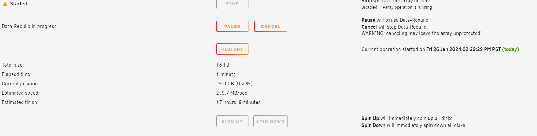

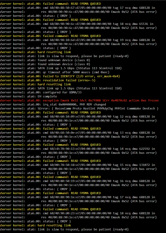

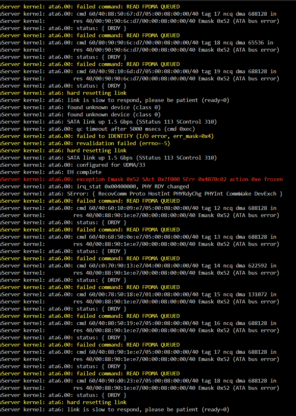

  3. Hi, I tried changing the placement of the hdds and ATA failed error changed with it, I changed all the cables, and the issue is still there. So i'm guessing the harddrive itself is has a I/O problem. Can it be that?
  4. EDIT: I started docker containers and the speed went down to ~15mbps, and I saw the following failed commands on logs window. Now I stopped the docker and the speed is around 140mbps

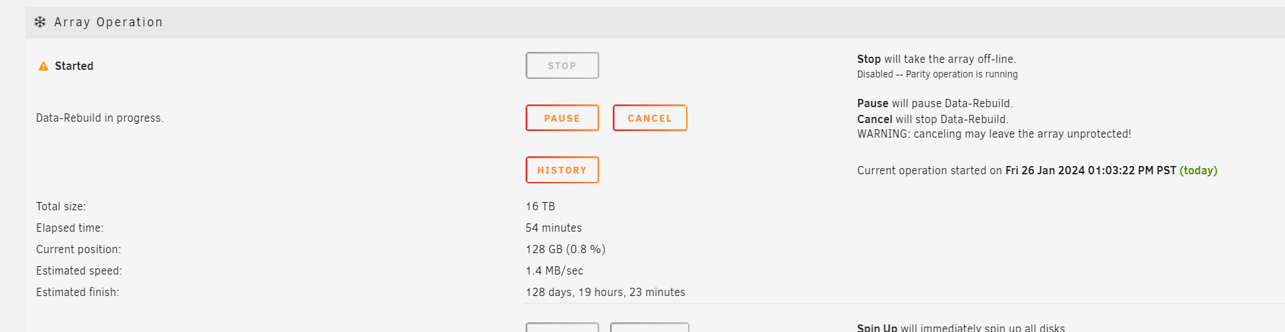

  5. I changed the sata cables and it seems to be working thank you. How did you see that error I would like to spot his myself next time? Also, do you have any ideas why LSI sas card caused disk 3 problem?
