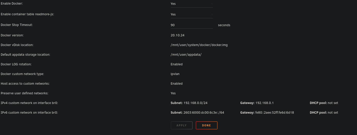

  2. NETWORK ID NAME DRIVER SCOPE 6fcca58e78a0 br0 ipvlan local 8dfd1116c7f7 bridge bridge local fdc42af76e27 host host local 97cc5bfe30c5 none null local e910a10c45ba rosenet bridge local
  3. I've switched to ipvlan in my settings for docker? So it shouldn't be doing that. I am using custom docker networks so would that override that?
