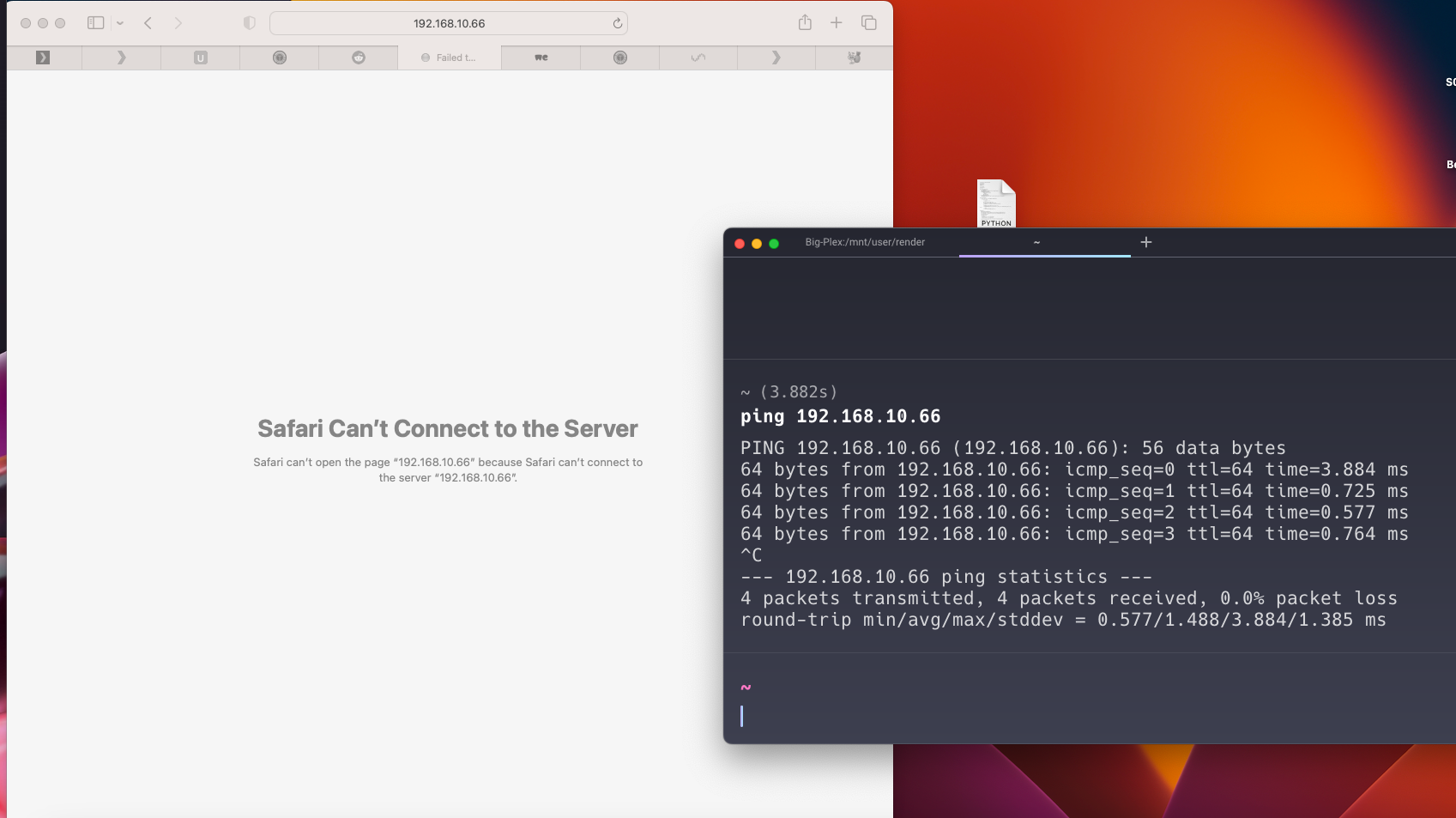

  2. Hi there, I can't hit the gui - even with a direct connection to the server. I can ping it that address and all connect to all other dockers just specifically the gui does not load. A reboot often fixes it but that does not seem to be working anymore. Any ideas? Thanks big-plex-diagnostics-20230519-1953.zip

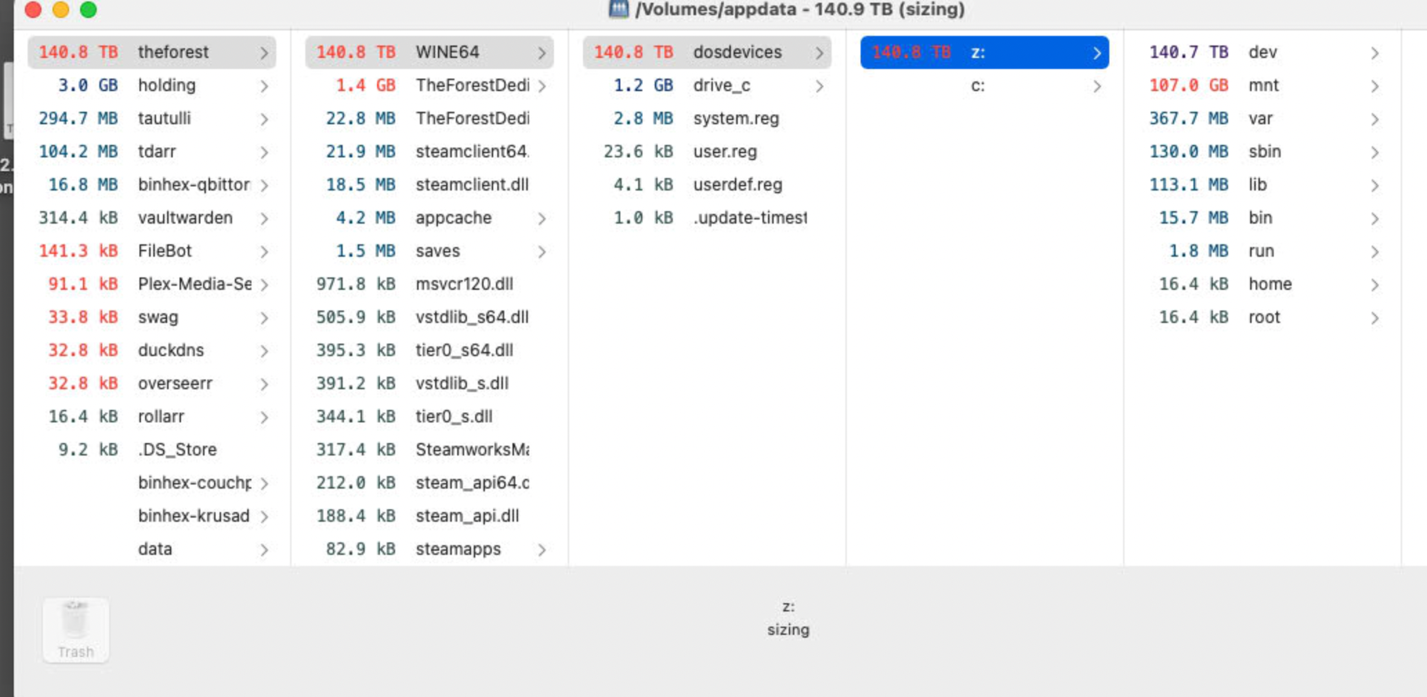

  4. Hi, Not sure if anyone has seen something similar to this before but I noticed one of my (2TB) ssds got full. I ran a scan and it was reporting a staggering 140TB inside of a docker (steamgame server from CA). Looks like its fixed by rm -r the folder but not 100%. Anyone else see something like this before? Pics attached. Unfortunately I couldn't get any deeper into the folder tree as it was lagging out the program Thanks!
