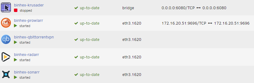

  1. Any thoughts on this? As of today I'm still having this issue, and I'm on the latest version of these containers. I should note that I'm still able to connect to the WebUI if I manually type in the IP of the container.
  2. Hello all - been having a weird issue with some binhex containers lately. First noticed it with binhex-qbittorrentvpn after a docker update - the "port mapping" info disappeared from the GUI, and clicking the WebUI button doesn't actually send me to the IP address of the web interface, it brings up a blank page (about:blank#blocked). Just updated radarr and sonarr as well, and now they are also doing this. Is this an issue with a latest round of updates or something I've got misconfigured? Thanks all.
  3. Hello all - having a weird issue ever since I moved my dockers over to a VLAN network, hope you can help. Used to have all the *arrs running on br0 on 192.168.0.0/24, moved them to 172.16.20.0/24 on br3.1620. Sonarr and Radarr work just fine (they are privoxy routed through qbittorrentvpn). Per my router's log files, qbittorrentvpn seems to be looking for DNS on 192.168.0.53, and so fails to start unless I allow it to access that IP with my firewall rules. I'm using PIA / OpenVPN config. I can run VMs or other dockers just fine on this VLAN, is there a way I can force qbittorrent to not look at 192.168.0.53 for DNS? EDIT: Looking at Radarr and Sonarr now in more detail - their webuis are available, but I am seeing the same requests to access 192.168.0.53 on my router log, which is being blocked by default since they are not on the same VLAN. Thoughts on why they are doing this? EDIT: Managed to get the dockers working by redirecting all DNS requests (port 53) on the VLAN to the pfSense DNS resolver. Still don't understand why the dockers are looking to 192.168.0.53 for DNS requests, instead of 1.1.1.1 and 1.0.0.1 which are in the NAME_SERVERS field. Are there any other alternatives available here? Thanks.
