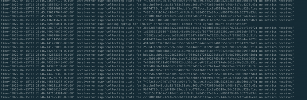

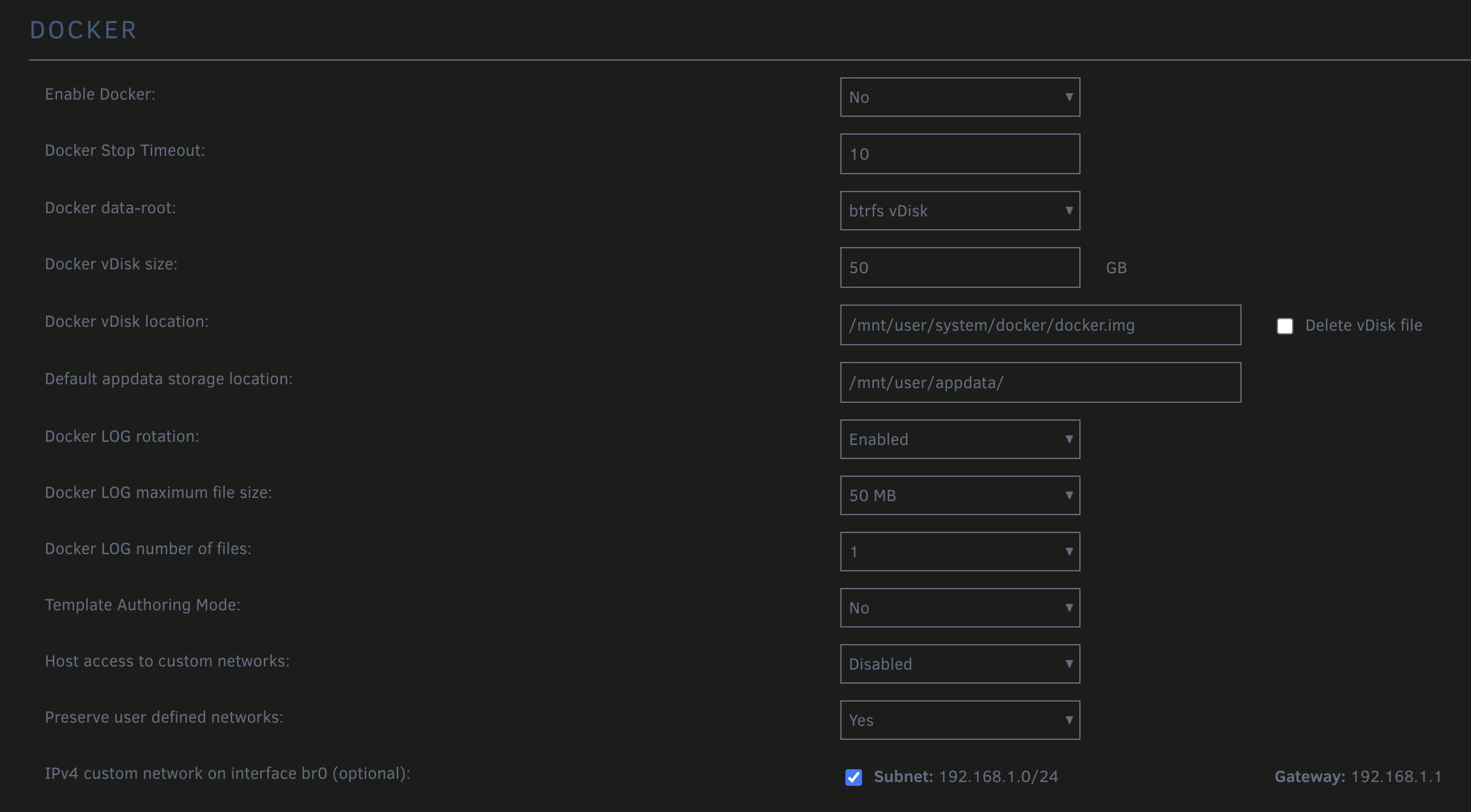

Based on this post and my settings, it looks like indeed these Docker settings are for container logs but not the daemon/engine. I've observed this, because the /var/log/docker.1 was 100mb rotated but I set rotation at 50mb. So these settings probably don't apply here. I also can't find a single piece of information about just stopping it from logging this error, and sure enough I restarted and it has started spamming this log file again with this error about collecting stats.
[SOLVED] /var/log/docker.log filling up with error messages "collecting stats for, no metrics received"
It looks like I do have that on with these settings. Will change Docker LOG maximum file size to 10MB and try that as well now.

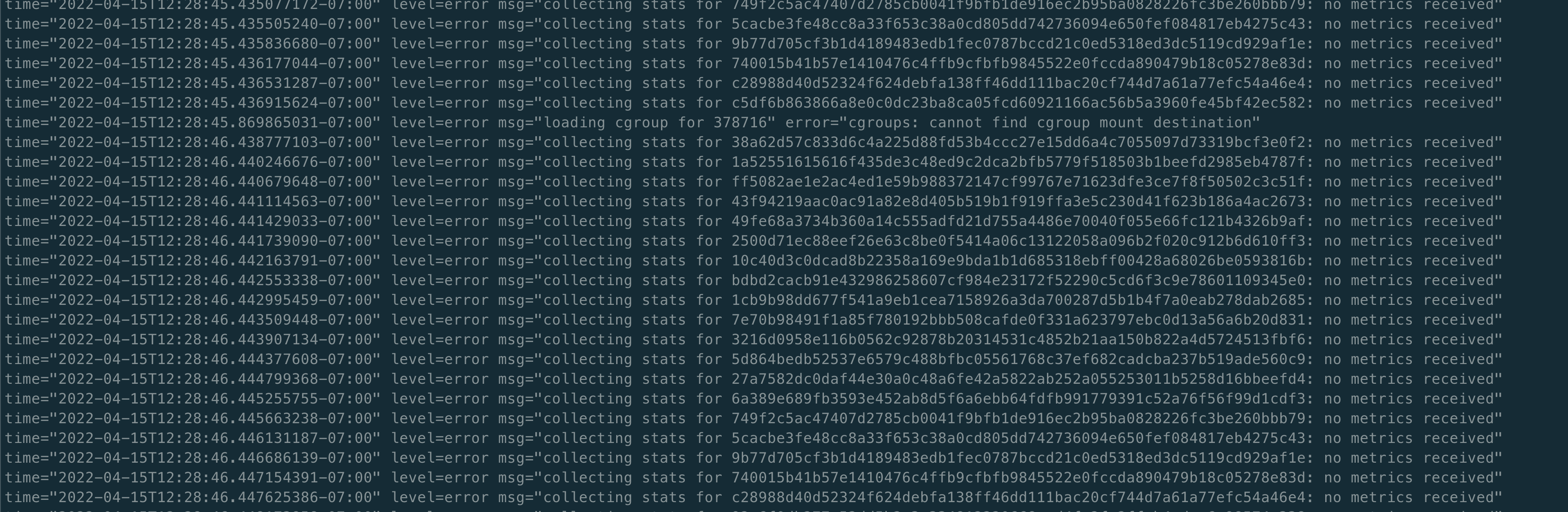

I've searched around but can't find any information on correcting the docker daemon to limit it's log file size. I recently got a FCP warning, the /var/log/docker.log was 128MB filling up the entire log fs. I deleted the extra content, but dockerd was holding onto a reference so the filesystem didn't reduce used space. I gave up and restarted and started tailing /var/log/docker.log. Here's the spam lines, searching around I don't see much mention of this information. Will post diagnostics if needed but this seems to be a particular issue with the docker daemon setup? I thought about configuring /etc/docker/daemon.json but I realized it would be wiped upon restart so I am posting to see if anyone else has any workarounds for this. I also was getting various messages about the cgroups as well.
