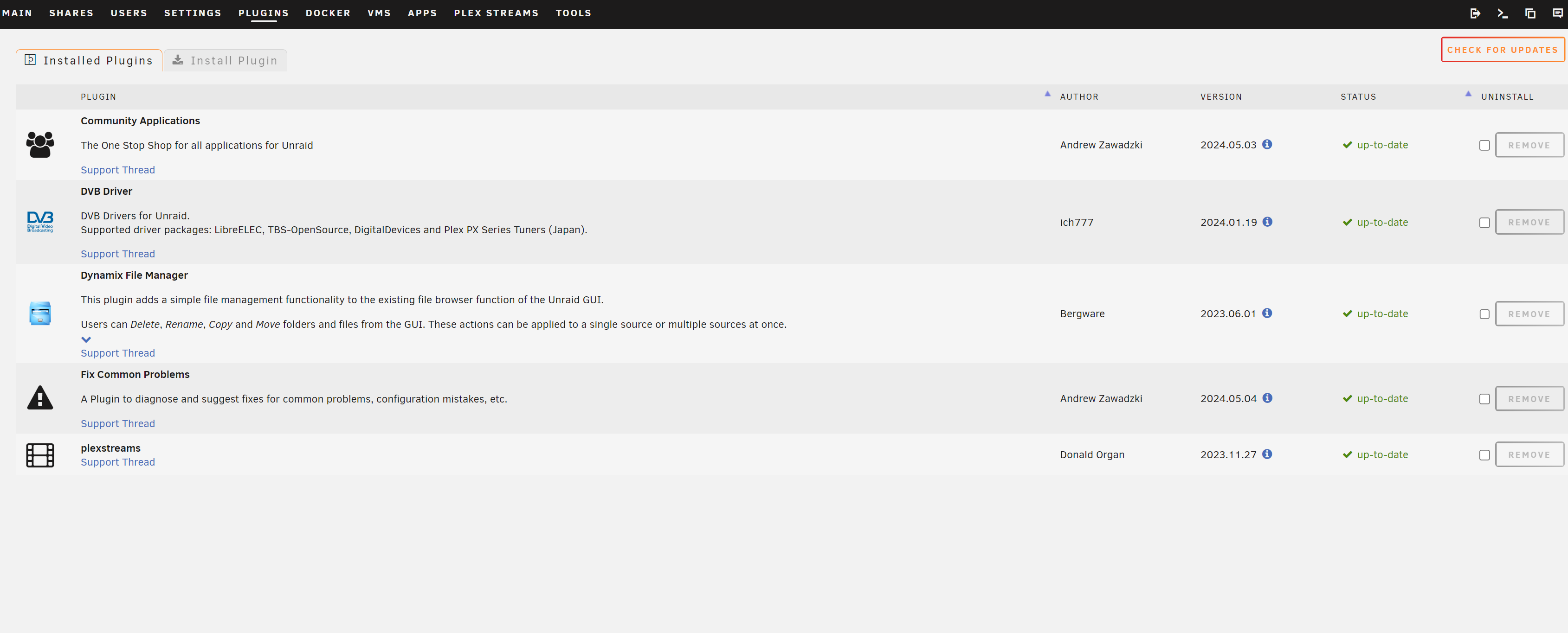

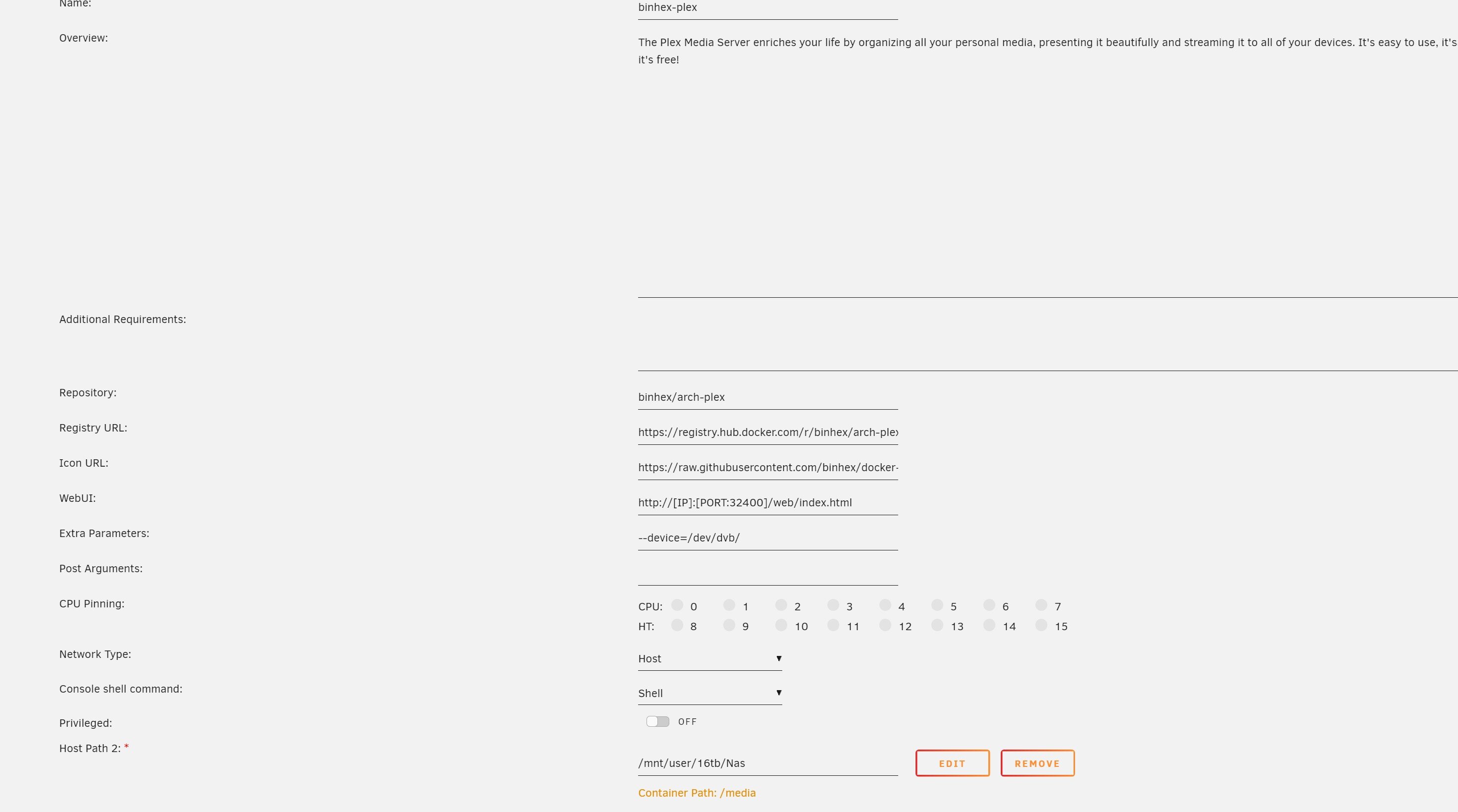

  11. it is a plex supported tv tuner from hauppage. Yes i already tested tvheadend with succes on unraid . today i will try using TBS-OpenSoucre Package for the drivers,and the two versions of plex the original and the linuxserver. is there a fast and easy way to change from binhex plex to the other one?

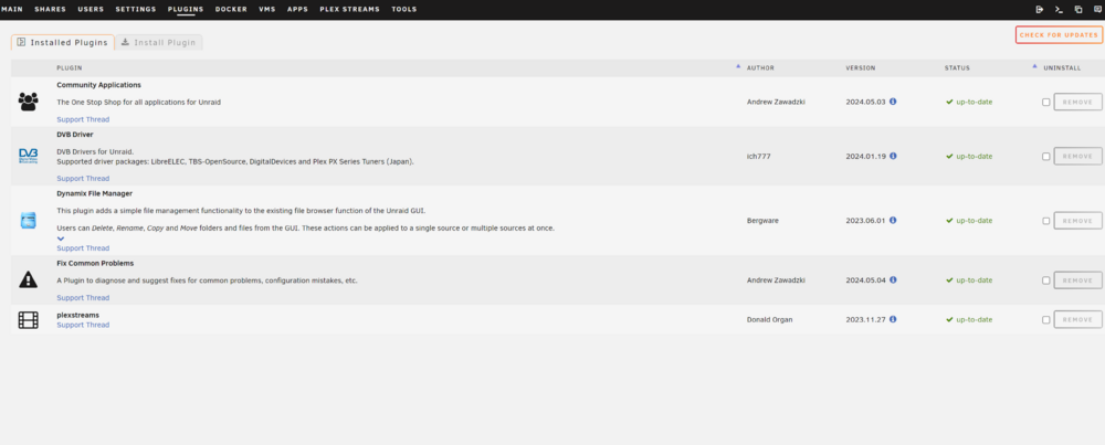

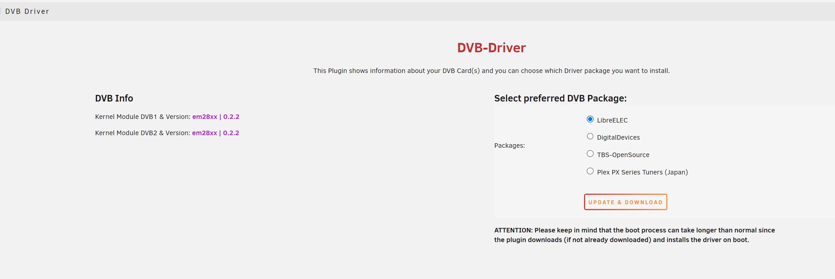

  12. So heres a screenshot with dbv drivers Can i use plex from linux server and plex from binhex at the same time ?I need several days to make the the transition because i have a lot of playlists
  13. Yes it is installed .the output of ls /dev/dvb is adapter0/ adapter1/ i have added --device=/dev/dvb/ as i mentioned in the second post but no luck
