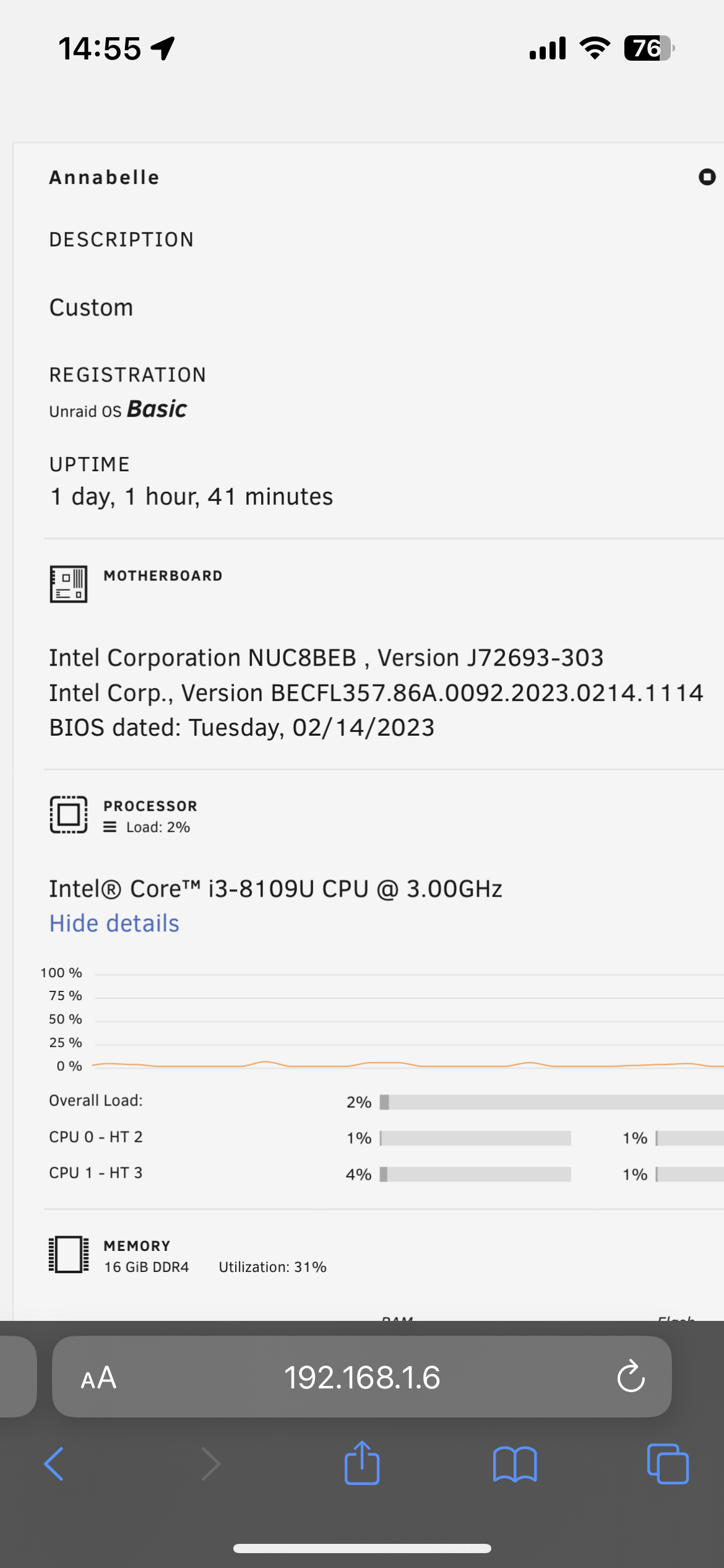

  13. OK based on some other topics (that were about Ryzen cpu's actually) tried to update the BIOS of the Intel NUC. updated again to 6.11.x about 1 hour ago and so far it's been stable. So for anyone coming here through google experiencing issues with a intel NUC and unraid 6.10+: Update the BIOS to the latest version: BECFL357.86A.0092.UEFI This seems to help.
