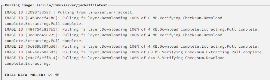

  1. I have a bunch of dockers that have updates available (qbittorrent, jackett, sonarr, etc. 11 in total). When I klick "update ready" the update process starts The image is deleted a new new is created, the container is started but I still have the "update ready" on the container. If I check Sonarr for instance, it says "New update is available" so it doesn't seem to update... Any suggestions?
