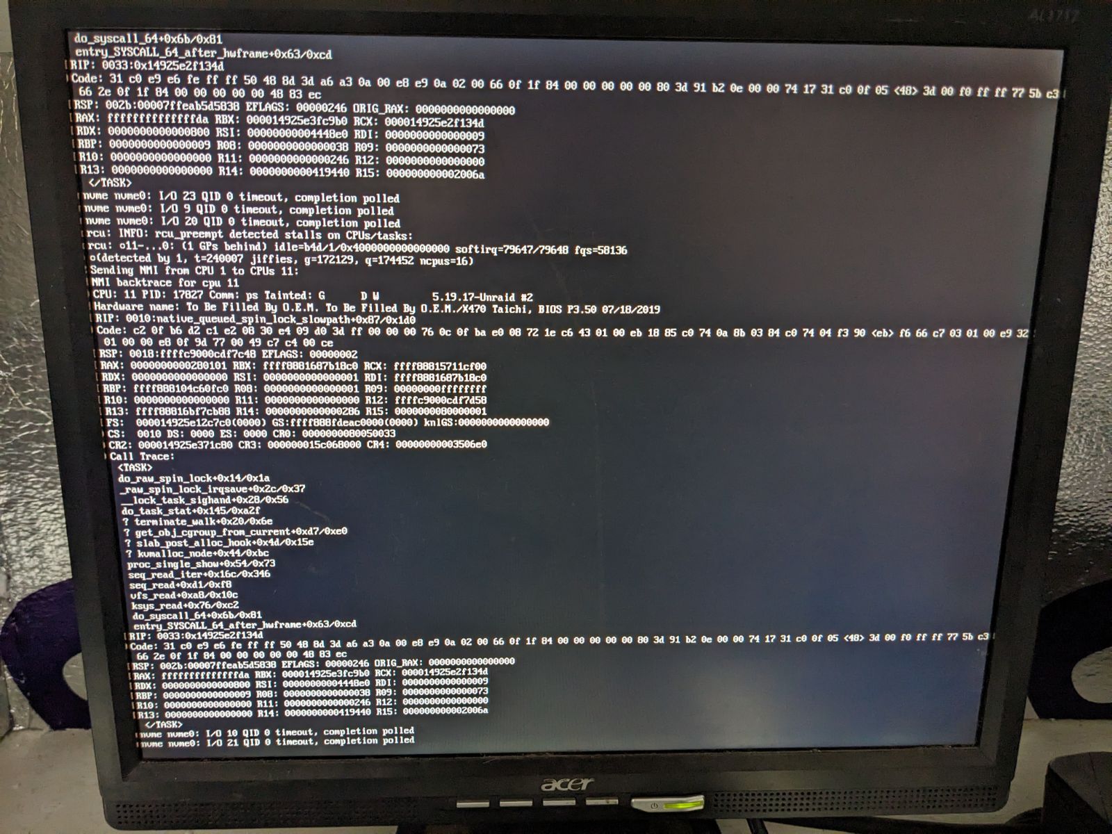

  8. wow everything went to heck. I was restoring my backups then everything stopped responding. I checked the server itself and it said something about a critical Kernel error. rebooted stopped all dockers and vms system is running parity check now; estimating 9 days 47 errors found total raid size 4.11TB out of 21TB. not moving past .3% I think I'm done with unraid. every time I try to do something simple everything goes wrong. All drives reporting healthy and good temps. Browser interface stopped respoding. Here is picture of the server screen. Looks like the nvme is not responding. Please any thoughts. tower-diagnostics-20230613-2230.zip
