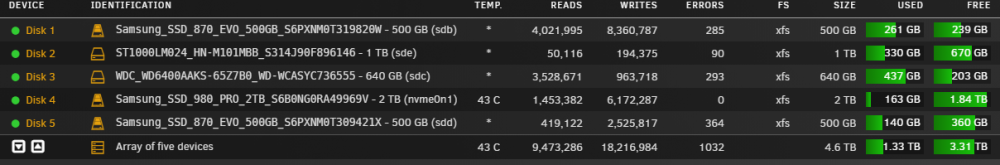

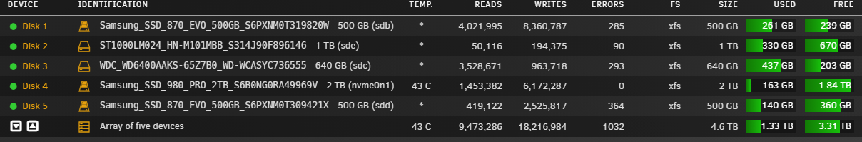

  10. Right, co mpletely forgot about providing log files. I have downloaded them and attached them here. However, this is after a system restart so I do not know how helpful they will be. At the time of posting these log files, the server had been up for about 1h 50m. asta-diagnostics-20220522-1547.zip
