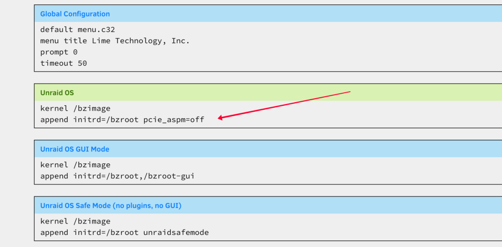

  2. I tried moving it the main PCIe slot and it seems to be working so far(Uptime 1 day 6 hours ), I also found this thread I'be adding it too and see how it does! append initrd=/bzroot pcie_aspm=off
